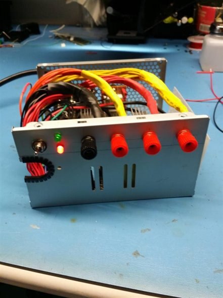

I have seen these around on the internet for a while and now i could use one. scored a psu for free so of course, i took it apart. Seems pretty straight fwd. gonna wire it up tomorrow.
I'll post a pic of it when it's finished.
*Edited* I finished this thing up today. I even made some leads for my breadboard. I tested all the binding posts with a multimeter and they all have the expected output. there was a -12v wire buried in the psu but by the time i found it was over drilling holes. This will do as is.
