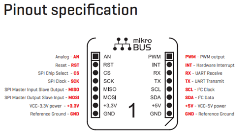

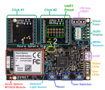

There are two Mikro BUS sections and an unpopulated section for UART Pmod (meant for right angle header). Pmod header allows for more UART devices. For reference, I chose a
Pmod MTDS: Multi-Touch Display System. Using the Pmod header would allow both MikroBUS clicks (1 & 2) to remain vacant. This would maximize the development board and open new secure IoT possibilities.
Pros:Cons:
3.3V and 5V option in same section (MikroBUS Click)Lengthy software connection process
Many peripheral choices (7 segments, RBG, IR, Touch sensors, LCD screens, etc)New development board so little information is available.
Nice quality pcb and well written documention & datasheet. Guides by Microsoft
Great concept for securing IoT devices
Board stays nice and cool to touch, no over heating or hot spots (1-5hrs running)
Variety of on-board sensors
