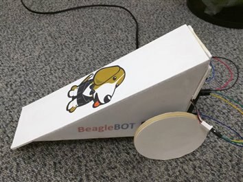

A Beagle Bone Black Bot controlled over bluetooth using a Wii-Mote
So my third and final Bot in the series. This time controlled using a Wii-mote over bluetooth. I came across a python module that allowed any linux system to communicate with a Wii-Mote using a bluetooth adapter. The module seemed very easy to use and very intuitive, and since I was doing the other bots at the time it seemed a logical use for it as I had all the hardware already built.
The chassis and electronics are all the same as my first bot, the WiFi controlled BBot (Ben). So head over THERE for instructions on how to build the electronics and everything.
You should start with something looking like this ↓ it will need two servos. One connected to pin8_13 and the other to pin9_42, you will also need a bluetooth dongle, I used order code 2102735 and it worked perfectly.

Plug in your BT dongle.
Then boot your board, Login, then type this and your off
sudo python ~/bt_bot.py
You will need to press the 1 and 2 buttons on your wii mote when you run the script to connect the wii mote to your BBB, then use the Dpad to control your bot.
You're off!
