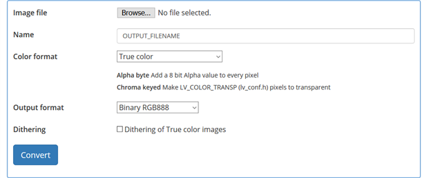

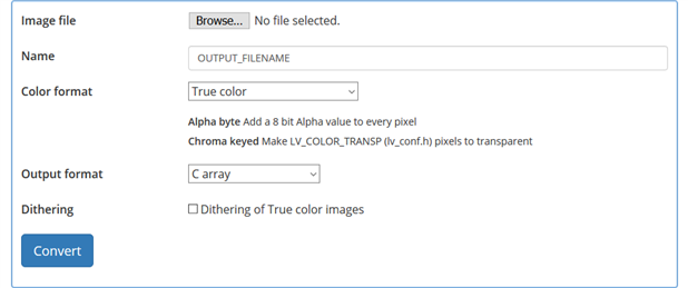

We can also use the simplified way the BMP image data read by generating the bin using online tool (HERE). And the code to read BMP image BIN data file is also provided below.
Figure-1: The online tool settings required to generate a image data C-array file to use with default 24-bit display setting
Figure-2: The online tool settings required to generate a image BIN file to use with default 24-bit display setting

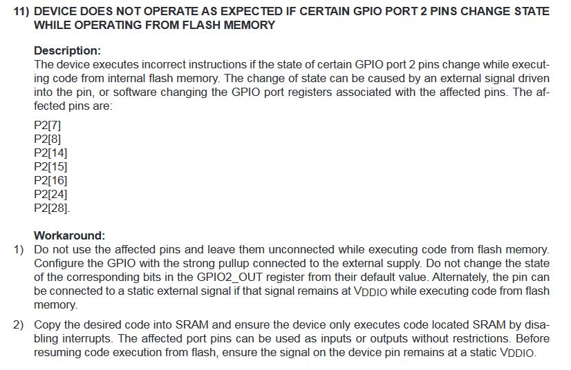

Display work same as mentioned in the datasheet only if image is stored into display buffer before enabling the builtin controller of MAX-32650. User can only update the display buffer with flash stored image data buffer after the initialization of LCD controller. After the initialization of LCD controller the rest of the code execution especially working with other external devices (SD-CARD, HYPERBUS RAM, SRAM, FLASH etc) will cause random hard-fault after random intervals. So in other word if display is initialized then user need to take of few things before executing the rest of the code. Best way to access external devices while avoiding hardfault is, only use the images with the zero red color. Or else user can choose the workarounds mentioned in MAX-32650 errata sheet as shown below.
TFT LCD is using P2_14, P2_15 and P2_16 GPIO while onboard PMIC MAX77650 is connected at P2_7 and P2_8 in EV-Kit. And both of these workaround are also tested by removing the red component from display buffer data and executing the code from SRAM instead of flash but it doesn't solve the problem of hard-fault when several image are continuously read from SD-card and displayed on the TFT LCD. Also there is no details about the Hyperbus RAM data corruption when LCD controller is in initialized state and data is read from Hyperbus RAM (details HERE).
The only possible way of using TFT LCD while avoiding hard-fault is using maximum of 8-bit color setting, avoid updating the entire display area at once and communicate with external devices only when LCD is in disabled state.
