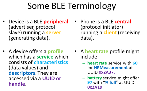

Any new communication protocol requires a vocabulary lesson. BLE is even worse than most, as there is a lot of terminology. The first hurdle is the name. Like standards, there are so many to choose from.
Bluetooth by itself means Bluetooth Classic. This is higher power and higher bandwidth. Most Bluetooth headphones are Bluetooth. The connection between your phone and car is Bluetooth. Right now, we don’t care about Bluetooth, this post isn’t going to talk about it. Starting now.
I lied. Bluetooth Smart Ready means it is a dual-mode device that is compatible with both Bluetooth (Classic) and BLE devices. A smartphone is Bluetooth Smart Ready. It can communicate via Bluetooth to your car to play music or to your Fitbit device to get steps.
Bluetooth Smart is also Bluetooth Low Energy or BLE. That’s the one I’ve been playing with. The names do sort of indicate versions but I haven’t unraveled which is which and I’ve stopped wondering.
All of my development has been on the peripheral, running a server. My devices have required some battery awareness and have mostly talked to smartphones.
Starting out, I got pretty hung up on profiles, trying to fit my projects into one of the many standard profiles and services. However, despite an overlap in functionality with some, they never quite work. While I’ve used the standard device info service and the battery service, for the actual data from a device, I’ve had to come up with my own service, with a set of characteristics organized into an attribute table. Whoops, more terminology.

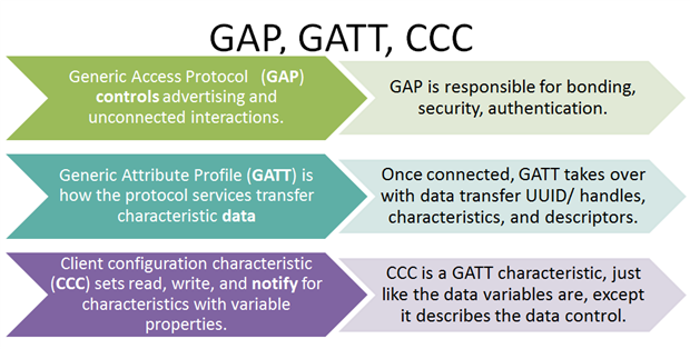

SimplePeripheral has a task that handles BLE messages (simpleBLEPeripheral.c). On initialization, we register callbacks for GAP actions like successful pairing or loss of connection. We set up our advertising packet, just modifying the one TI provided. Somewhere in there, we also register some services. The device info is a standard one (DevInfo_AddService) but our data will go into a vendor service. This example supports a simple one (SimpleProfile_AddService , in simpleGATTprofile.c).

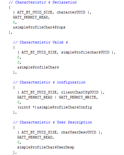

This looks familiar, right? The UUIDs are 16-bit identifiers that let us access the data in the table. The descriptor strings are for the humans who have to figure out which is which. They are optional in BLE but helpful for the example.
The most interesting part of this example is the fourth characteristic. First, its property is notify. This implicitly implies that the property is also readable but it is better for data that can change on the device. See, the central (e.g. your phone) has to initiate all transactions with the peripheral (e.g. your device). If a characteristic is readable, the central will query the peripheral which will respond with the value.
However, for notify characteristics, the central won’t have to poll the data; instead BLE will let the app know when the characteristic has changed. You can change the configuration later, from the central (look for CCC in the code to see how that works).
These variables are all set up in the attribute table. This is the data that the GATT protocol deals with. You can put in callbacks so you get notified when the characteristics are read or written.

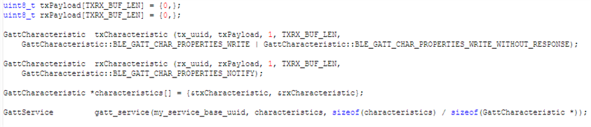

Switching from TI to Nordic and from IAR to mbed should be a big change and it is. Still, the BLE interface is reasonably consistent. First, there are several RedBearLabs demos including Heart Rate, Thermometer and BatteryLevel services and an iBeacon. I started with the nrf51822_SimpleControls example, though I made a few variable name changes in the snippet of code.
We have some UUIDs, not defined in the snippet shown, and these UUIDs get attached to variables which have properties. In this case, it is two variables: txCharacteristic for input and rxCharacteristic for output (these are tx and rx from the client application perspective, not the device). These are just chunks of memory (20 bytes each, the maximum data payload).
Data
Variable in the code
Settings (aka properties)
Input data from the client
uint8_t txCharacteristic[20]
Notify (readable, will notify the client when a change occurs)
Has a UUID
Output data to the client
uint8_t rxCharacteristic[20]
Writeable only
Has a UUID
Thinking back to my accelerometer data, I could put my XYZ into three different characteristics or I could byte pack a structure and send them over all at one time. BLE doesn’t care.

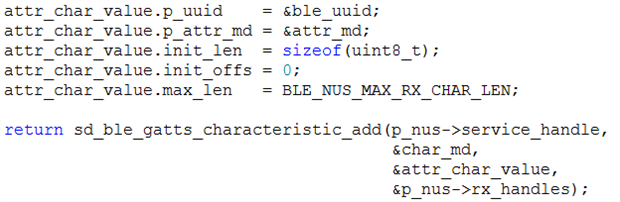

NRF51822 in Keil
I used the free, space limited Keil compiler with a client’s custom board. I did not expect this to work but by the time I used the Nordic BLE stack’s dual banking system to update my firmware, allocated some flash to do logging, and to store code for another processor, I couldn’t have made a much larger application anyway.
Nordic/Keil have a ton of examples, overwhelming though organized reasonably in the Pack Installer. They seem to have an example for each BLE standard profile as well as for each processor feature (SPI, UART, pin interrupts, etc.). This leads to the problem of where to start. Having looked through them again with an interest in giving you a hint, I’m still not sure. The one called experimental_ble_app_uart_s110_pca100028 allows functionality similar to the mbed example above: a 20 byte characteristic.
There is another similar sd_ble_gatts_characteristic_add call for the transmit characteristic.

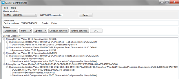

I mainly used the Nordic PCA10031 BLE dongle for debugging. I know that this dongle can be configured to work with Wireshark. I kept meaning to do that but never did. Instead I used it with the Nordic Master Control Panel (MCP). This let me discover devices and connect with devices around me. Upon connecting, I could read the GATT information (via discover services).
TI has BTool that serves a similar purpose (and a few more). However, once I got used to MCP, I didn’t try to switch.
The other way to debug is on a smart phone, Android or iOS. There are many apps available to sniff BLE packets. At various times, I used the Nordic nrfToolbox, TI BLE Multitool, and the generic LightBlue. They will show you the devices in range, their advertising messages, and allow you to connect and interact with the data.

What about the UUID? That creation has always happened off screen.
Looking back at the MCP output of the AppleTV, the first entry for the device name is short; there isn’t a lot of hex cruft. It is part of the BLE-defined device info service which uses 16-bit UUIDs. However, looking at the last entry, the UUID is a 128-bit beast. If we pass that back and forth, our 20 byte packet will disappear to nothing (and we consume additional power passing data no one cares about).
Instead, our app will most likely use a handle instead of the UUID to access the custom data. This is simply an offset into the attribute table. It is easy to use though if you change the attribute table, your handles may need to be reshuffled (and that is why we need version in the standard device info, so we can change the data organization in the future).
