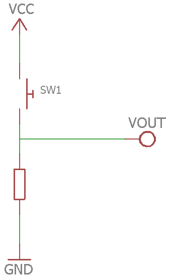

Let’s start off with a simple schematic. Press the button, and VOUT goes to VCC. Release it, and it goes back down to GND, through the pull-down resistor.

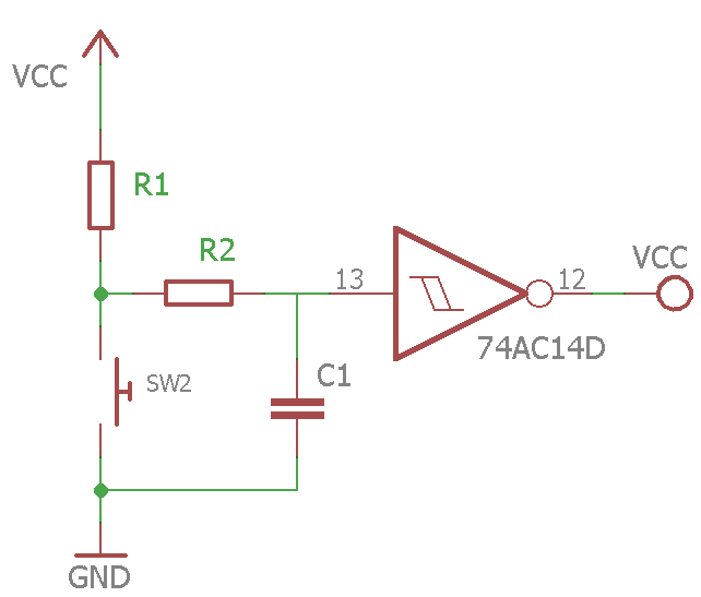

RC
Electronically, you can add a resistor-capacitor to slowly charge and discharge. This will add a small delay to your circuit, the time it takes for the capacitor to charge up.
The 74xx14 Schmitt inverter will detect a voltage above a certain level as a logical one, and invert it to zero. Likewise, a voltage below a certain level will be detected as a logical zero, and inverted to one. By adjusting the resistor and capacitor values, the capacitor charge time can be changed, filtering out unwanted bounces. Likewise, when the switch is released, the voltage is discharged through a resistor, removing bounces.

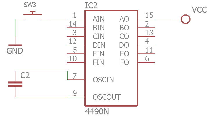

There are devices that are dedicated to debouncing switches and pushbuttons.
In this example, an MC14490 is used. It has internal pull-up resistors, so no external components are required. The capacitor C2 is used for the internal oscillator, and apart from that component, no other components are required. The only down side to this situation is the price of the component itself; around 5€ per component, but each one can debounce 6 switches.

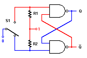

    Good topic, my first system failure was due to switch bounce. I wish someone had explained it to me earlier. I prefer to use a double throw switch whenever possible because it can be debounced quickly…

    I prefer to use a double throw switch whenever possible because it can be debounced quickly without ambiguity:

    This circuit is very reliable.  First saw it in AofE if recall serves.  This is a reset-dominated flip-flop.  It works because the high-to-low transition and low-to-high transition are separated in space and time.  This configuration requires a break-before-make type switch

    Here it is from the "RCA COS/MOS Integrated Circuits" databook from 1975. This is from one of the application notes at the back. Theirs is the other way up with a pair of NOR gates, the switch goes up to the rail and the resistors pull down.
    Previously, the NAND form had been usual with TTL because of the current that had to be sunk to pull the input low. With CMOS that no longer mattered.
    Jan Cumps over 9 years ago in reply to jc2048
    I've implemented (read: stolen from the internet) that circuit in VHDL to debounce button signals in an FPGA.
