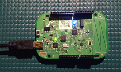

The device is "hello world" for inertial sensors so I keep rebuilding the code for different processors and inertial measurement units (IMUs). The platform I want to show today is a Freescale Freedom KL05Z (FRDM-KL05Z) with a sensor toolbox shield (FRDM-STBC-AGM01).
The KL05Z processor is a Cortex-M0+. The $13 dev board is laid out similarly to an Arduino (though as it runs 3V, not all shields are compatible without additional hardware). The system is mbed compatible so there is a free online compiler with lots of great examples.
Happily, the dev board comes with an accelerometer and RGB LED and already had the first part of the demo implemented in its power up code: accelerometer XYZ measurements show up on the RGB LED. When the accelerometer is sitting on the desk, it shows a steady light. If it is flat, the light is red (X-axis), green (Y-axis), or blue (Z-axis). Motionless, it provides a nightlight.

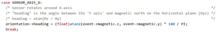

To that end, I highly recommend reading Adafruit’s Kevin Shaw’s 9DOF code to get a better sense of what is involved. One of the first things you’ll in the function magGetOrientation is a switch statement.
Before we get to the trigonometry, as this code shows with SENSOR_AXIS_X, you have to answer the question of what you measuring with respect to. The inertial sensor doesn’t read what the system is doing: it reads what the sensor is doing. Another way of saying this: the body frame is different from sensor frame. You can use matrix math (orientation matrices) to convert between them but you need to know the relationship between the sensor and the thing you want to sense. How you mount the sensor to the robot/car/drone matters.

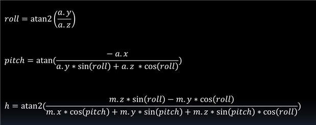

Now, back to the math. The arctangent snippet above is the trig you need if you are calculating heading with only the magnetometers. However, that’s a terrible idea. It means you have to keep your magnetometer level to get a result. That’s difficult. Any mistake in levelness leaks errors into the heading calculation.
The Adafruit fusionGetOrientation code shows a different way to do the calculation, using the accelerometer readings to calculate the roll and pitch of the device. Then it uses these tilt values to calculate a heading that doesn’t depend on the device being level. Tilt-compensated magnetometers are much more accurate.
This is so common that magnetometer-accelerometer combination chips are becoming ubiquitous (such as the FXOS8700CQR1 used in this project). My light uses this tilt compensated heading to guide you.

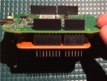

Solder the headers on to the Freedom board (note: this is easy soldering, just headers, don’t fear the soldering). You can use stackable headers so your Freedom board is more flexible in the future. Alternatively, you can use the male board connectors (Note: either way put the pointed pins away from RGB LED side of the board).
Next, install the sensor toolkit shield by fitting it on the connectors you soldered on.
