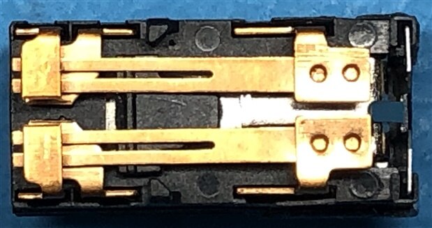

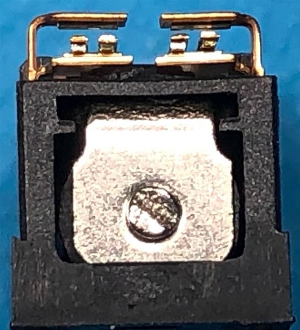

I would think we're all used to seeing modern relays that plug into breadboards and PCBs to switch signals.  I've opened one up, mostly, to see what's inside - mostly - I wanted it to still work after surgery!:
A 9V DPDT relay - you can see the contacts, which are Normally Open (NO) in the image above.

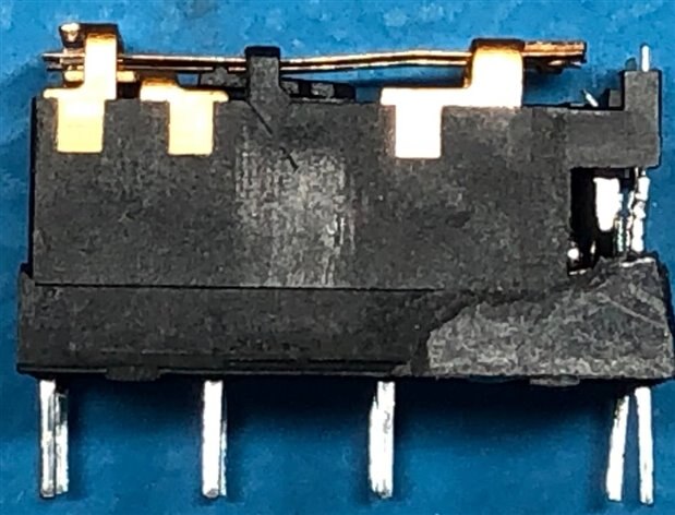

Same relay from above and side, contacts on left.  Here you can see the movable armature(contact) springs.
Not shown in the images above is the coil - that's hidden in the body.  Just as a recap of how a relay works - a voltage is applied across the coil terminals (pins on the right) which magnetises the coil itself.  That operates the armature(s) closing* the contacts and allowing a separate signal to flow through the relay terminals (3 pins on the left.)  That's a simplistic explanation but suffices.

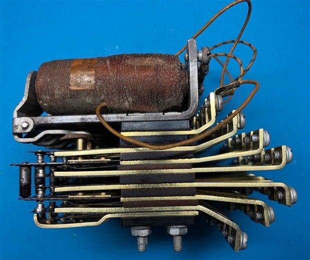

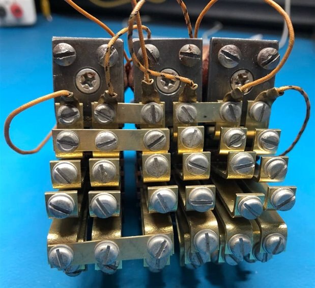

So we're in a world of miniature relays but in the words of Crocodile Dundee: "Call that a relay?  That's not a relay.  THIS is a relay"
The image above is a British Tabulating Machine Company Ltd Type A Multi-Relay, here with the coils and contact spring terminals visible.  There was no, one, configuration for a Type A relay - they were built up from a parts bin into the configuration required and BTM used them for the punch card machines they built.  Here, we see a relay that we (the Bombe rebuild team) use on the Bombe for indicating letters in the machine's Indicator Unit - BTM were responsible for the design and build of the Bombe under the codename CANTAB and chief engineer Harold 'Doc' Keen.

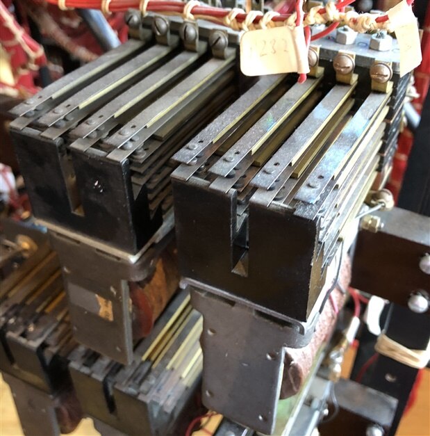

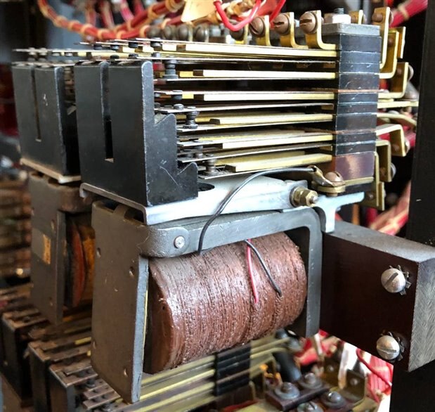

Firstly, I need to point out that the Type A relay as seen above was not used on WW2 Bombes, we've had to use 5 of these because we can't find enough of the Multi Relays that were actually used on the Bombe:
As you can imagine, getting hold of any parts that are 80 years or so old isn't easy but we can, and have, built up alternatives that whilst still maybe 50 - 60 years old are more findable.  The images above show that similar mechanisms to small, modern relays are used, just on a different scale.  The coil, under the yoke, is energised creating a magnetic field that pulls in the armature at the front of the coil, which is hinged and lifts the armature (contact) springs in the relay pile up above the yoke.  This relay consists of two pile ups with a mix of changeover and break before make contacts.

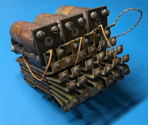

Back to the Type A relay unit which is in a bit of a sorry state, but it's had a hard life before we got our hands on it, and I've removed it from the machine to clean up as far as possible.  It consists of 3 coils and 3 pairs of Relay Pile Ups (6 Pile Ups altogether) used to indicate one of 12 letters on the machine's indicator unit - really it's 3 linked Type A relays, you should be able to see the shorting bars on some of the contact spring terminals.  On the Bombe itself we have 5 sets of these plus 2 of the contemporary 'correct' multi relays that can indicate one or more of 26 letters across 3 Chains.  I'm aware I'm using terminology from the Bombe here but basically:

That's it for the Bombe and contextualising the relay.  As I say, I'm taking this apart to clean it - there's lots of gunk and rust in the mechanism and it is way, way out of operating spec.  Normally I would use an electrolysis bath to clean up the steel parts but as it is the first time I've done this I wanted to be a lot more hands on and get a feel for the parts and the operation.  This time then, I'm using very fine steel wool, cleaning paste, IPA and more patience than is right for any one person to possess - to give you an idea, it has taken about 45 - 50 hours to clean the whole lot.  Here's a comparison and a good photo of one of the pile ups:

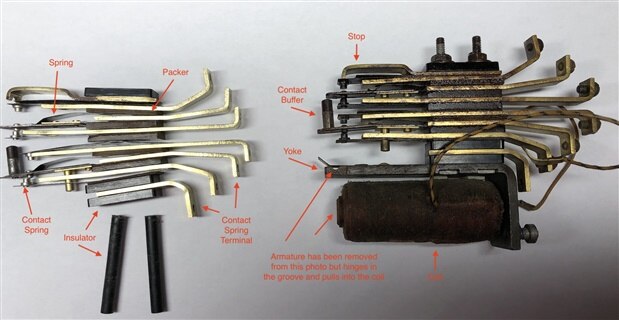

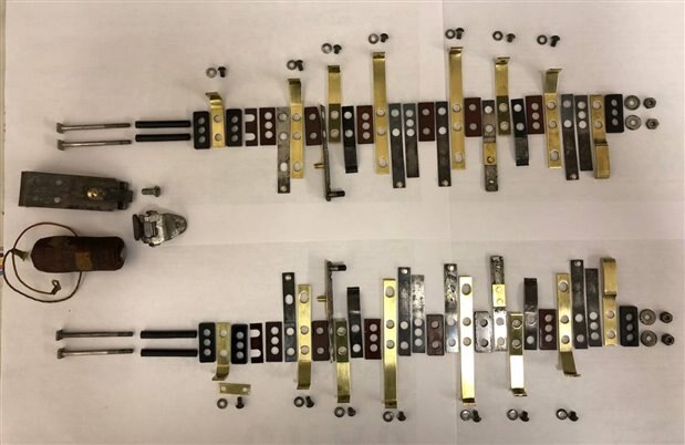

Anyone who knows anything about these things can see immediately how far out of adjustment it must be (also, how dirty it is.)  There's quite a few parts in each relay pile up and below is an exploded view of just one of the 3 relay units:

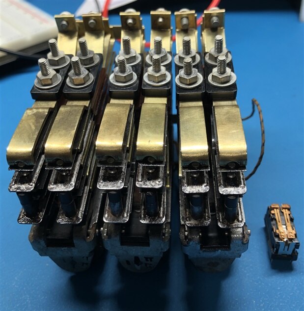

A lot cleaner but still out of spec.  As a comparison of size:
Of course, there are bigger relays used in industry than we use on PCBs and breadboards but the Type A relay was in common use until at least the 1960s (as far as I can tell!)
