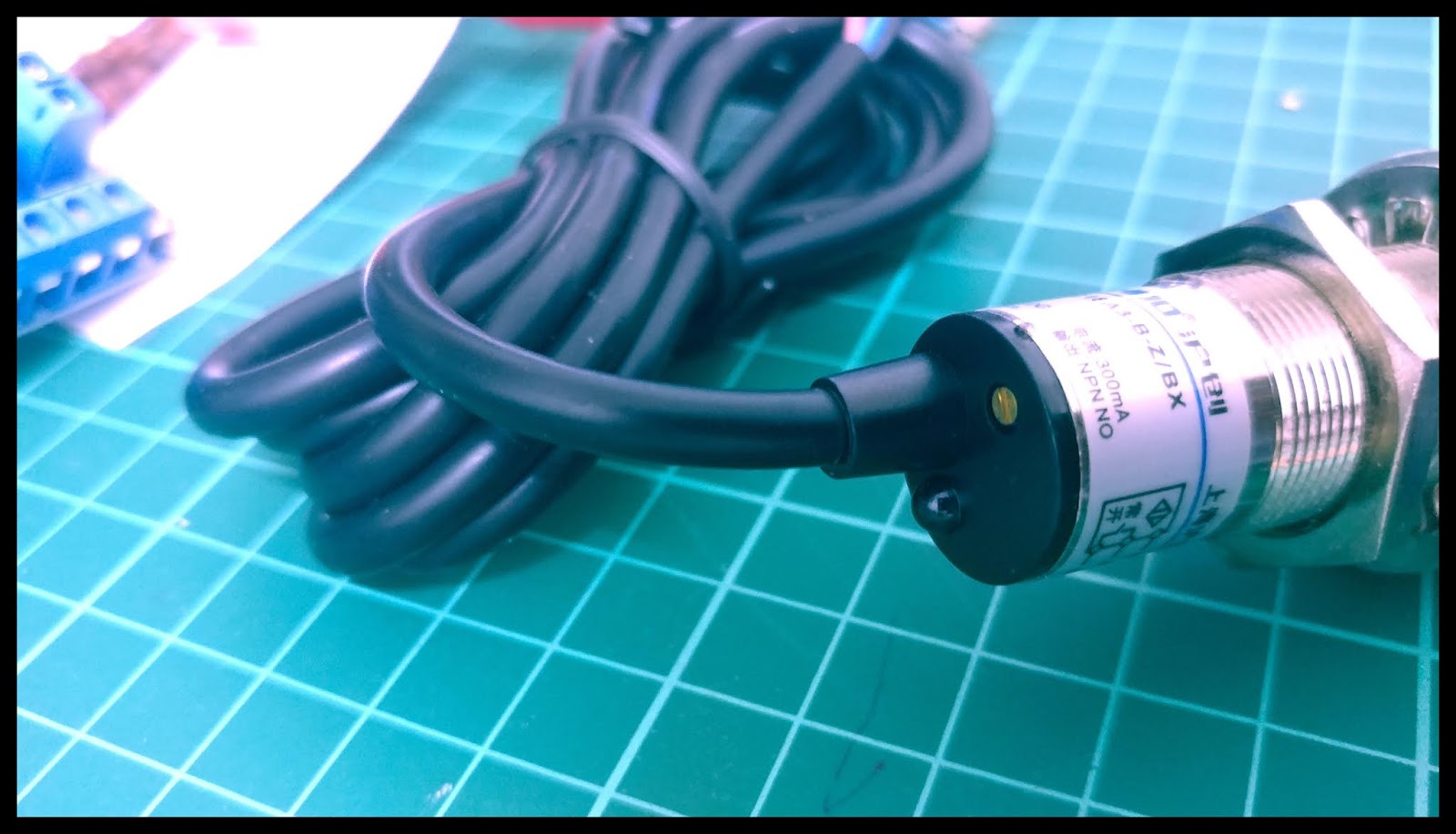

                       Basically that is the basic introduction and the theory of the sensor. Below are some more images of the product.

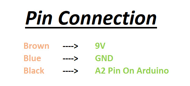

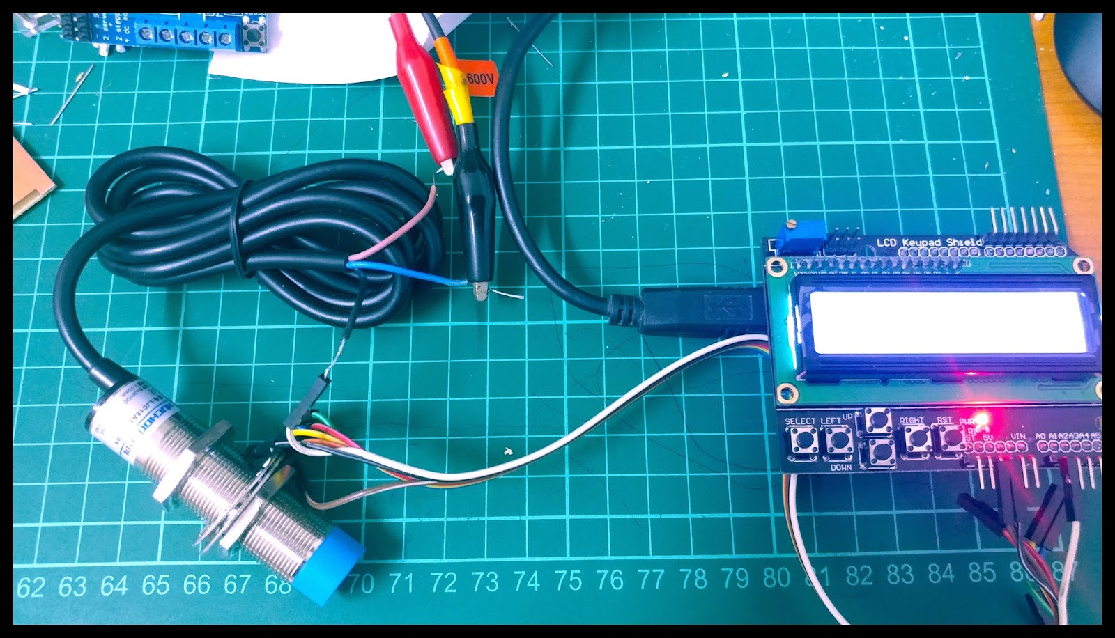

                     The sensor was put under test by interfacing it with Arduino. The connection was done as per the diagram below
The pin connection is as below:

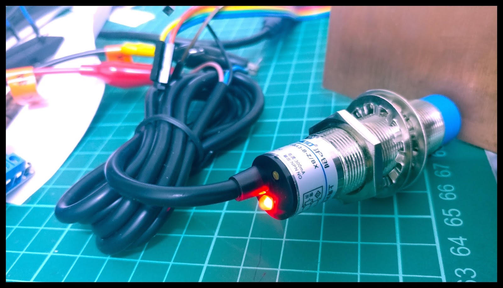

                When the object is detected, the led at the rear of the sensor will light up.

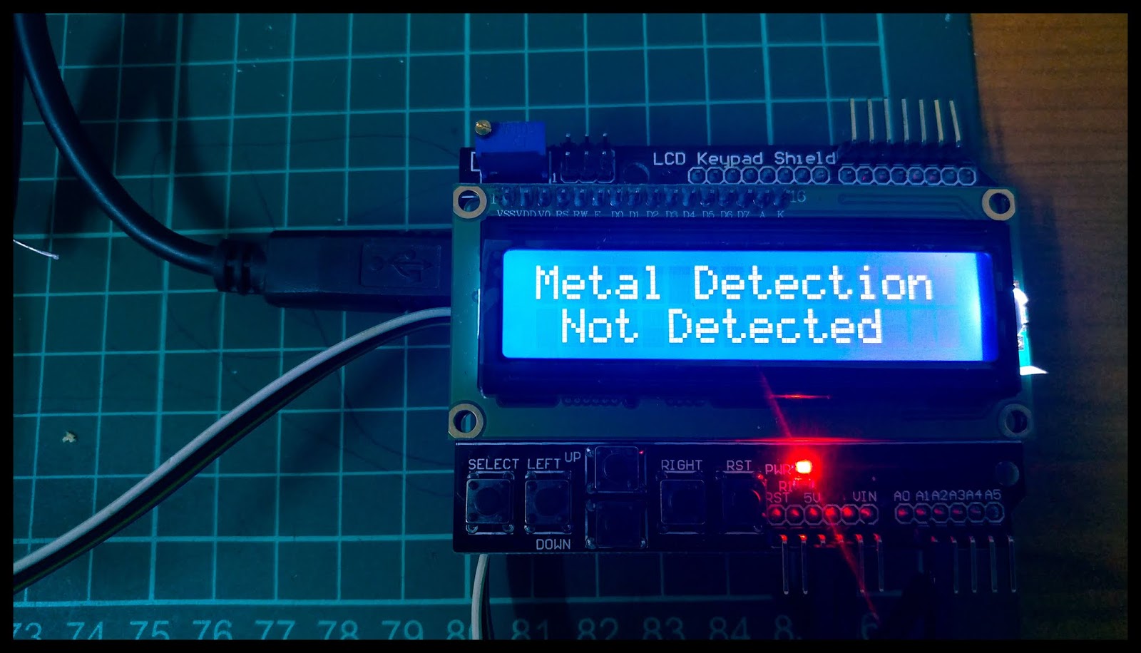

And below is the result when the sensor was put under the test.
