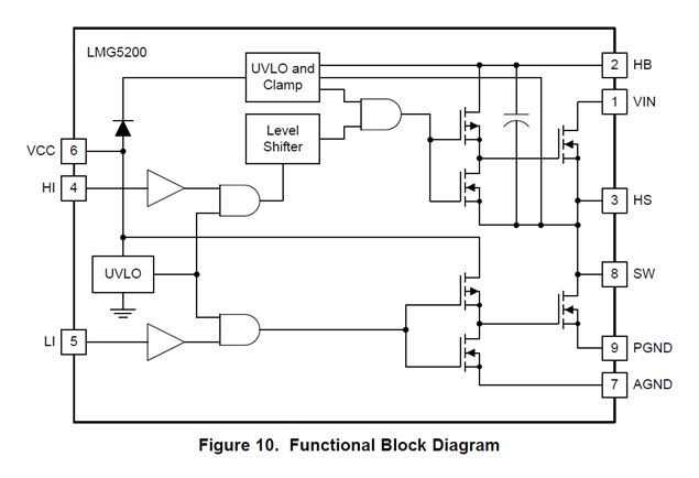

It doesn't have to be silicon all the time. I have a Gallium-nitride device here at the Cumps lab that I'm going to try out. In some high voltage, high power designs, GaN FETs have advantages over Si. On the other hand they are also more difficult to drive.
The chip that I have contains a built-in smart GaN FET driver. That takes away the complexities of driving the power stage correctly. We're covering fairly new technology here. The documents are still marked technology preview. I received them from TI after attending a GaN seminar and answering right on the quiz.
In this post I'm doing a first try-out. I'm powering a 12V 1.25A load.
What's in the package
I'm using a TI LMG5200 GaN Half-Bridge Power Stage. That's a fancy title for what is in essence a 2-FET half-bridge setup with driver logic in a single package.
The driver stage takes care that the not-so-easy to-drive FETs are kept within their safe operation boundaries.
Unlike many integrated smart half and full bridges on the market, you can control the output of the high and low side separately.
Taken from the technology preview document lmg5200.pdf.
These are my very first steps, so I'll focus on trying the driver in this post. I'll cover specifications and technology in a follow up.
TI's GaN overview page, Gallium Nitride (GaN) Solutions | Overview for Gallium Nitride (GaN) Solutions, has some good info on the technology.
It's vendor biased info, but I bet you're smart enough to filter that out.
