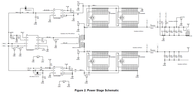

GaN Power Stages

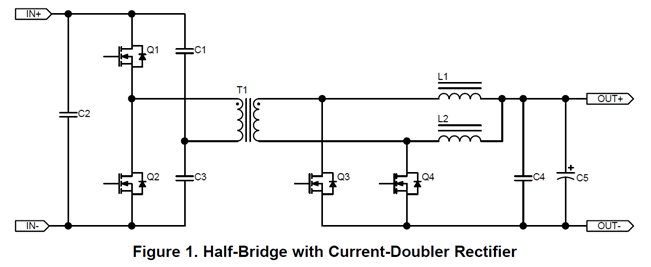

This isn't the simplest circuit. It consists of a half-bridge Buck converter, a transormer (a funny one) an output rectifier with filtering.
Primary Side
source: Using the LMG5200POLEVM-10 48V to Point of Load EVM

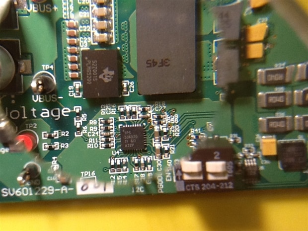

The half-bridge on the primary side is a GAN device that I've extensively reviewed in previous blogs: LMG5200. Check the blogs for details.
For this design, it's essential to understand that it is used as a typical Buck and that it switches at high frequencies.
We'll visit this component again when we check the PWM controller (it's a smart one with i2c interface) that is the brain of the converter.

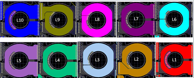

It's built from PCB traces, with a ferrite core over it. SO no wires in this transformer , just a single PCB trace on each side of the board.
edit: This is a 10 layer board. The Transformer has a 5:1 ratio. Check the comments below.
Planar transformer surrounded by a ferrite core
(two half cores that connect trough rectangular openings in the PCB)
10 layer board with 5 primary windings and 1 secondary winding
Layers 1,4,5,7,10 dedicated to the secondary side (each one turn in parallel) and the other to the primary side (one turn each in series).
The stacking goes S PP SS P S PP S (S=secondary P= primary).

This is a GaN transistor based rectifier and an LC filter to smoothen the output.
The gates of these transistors (in reality Q3 and Q4 in Figure 1 each are constructed with two discrete GaN FETs) are driven with the same signal that drives Q1 and Q2 on the primary side.
Core of the power circuit. Additional decoupling and filter caps not shown here.

In the next blogs, I'll check out additional circuits on the development kit: the step-down controller and the on-board 10A pulsing(!) test load.

    Jan Cumps over 7 years ago in reply to Jan Cumps
    Jan Cumps  wrote:
    The planar transformer is build on a 10 layer board, with layers 1,4,5,7,10 dedicated to the secondary side (each one turn in parallel) and the other to the primary side (one turn each in series).
    Please reference to the picture below.
    https://e2e.ti.com/cfs-file/__key/communityserver-discussions-components-files/1001/48pol-xfrm-layers.bmp

    Jan Cumps over 9 years ago in reply to jc2048
    You were right, Jon. We have an answer from alberto@ti.
    (source: my question on e2e@ti)

    jc2048 over 9 years ago in reply to Jan Cumps
    I realised after I wrote it that I was slightly wrong. The top and bottom traces constitute a single winding (they go once round the core). So the internal part would need to be five turns, however it was done.
    Maybe it explains the odd areas, halfway round the single turn, connected by 5 vias, that don't seem to connect to anything else.
