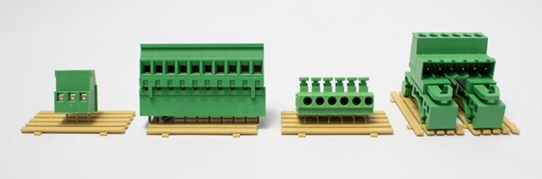

CamdenBoss manufactures and stocks four main types of terminal blocks
Standard PCB terminal blocks are your typical wire to board assembly connectors, soldered onto the PCB by through hole pins. They provide a screw type termination to hold the wire in place and utilise either a wire protector or rising clamp terminal. Within the range a comprehensive selection of low and standard profiles are available, alongside larger blocks for higher current requirements. The pitch sizes in this category start at 2.54mm pitch and work up to 10.16mm, providing an ideal selection for various applications.
Pluggable terminal blocks work using two halves, a male terminal block that is soldered to the PCB and a female terminal block that acts as a plug. This method is more commonly used in applications where disconnection and reconnection are required, for example maintenance reasons or plugging in diagnostic equipment to machinery. The wires do not need to be taken out and therefore save the user time. Pluggable terminal blocks are a slightly more premium product; however, they are more efficient in many ways compared to standard terminal blocks.
Screwless solutions share similar aspect to that of a pluggable block, in the sense that they can help reduce maintenance and set up times of large assemblies. An actuator or lever is pressed, opening the cage clamp, in which the wire is inserted and held. Like rising clamps, the cage clamp does not become perished and provides a premium alternative to standard connectors. Available in pitch sizes from 2.54mm up to 7.62mm.
CamdenBoss also manufactures a choice of DIN Rail mounted pluggable connectors, available in either 5mm or 5.08mm pitch sizes. Using this style, a pluggable connection to a fixed DIN Rail installation can be achieved.
