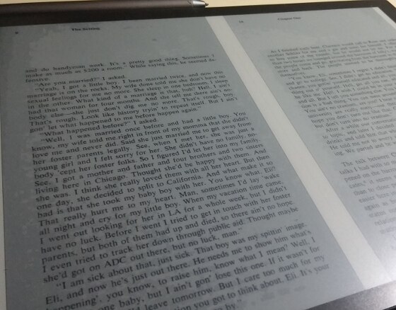

For example, this online copy of Elijah Andreson's "On the Corner" Sociological study looked like this on my e-Reader:
The gray background distracts one from the text and makes reading arduous.

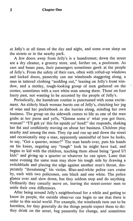

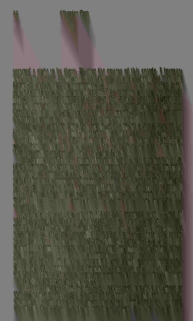

This generates about 8GB of *.pbm and *.ppm files. PNM files contain the scans of the pages with text shadows and other elements such as stains or handwritten notes. PPM files contain their negatives:
We only need the PBM files and we'll convert them to PNG to retain image quality. You can do this for all the PBM images in the folder with

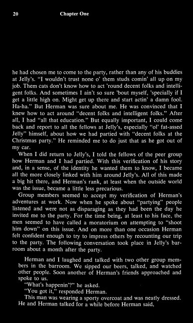

Now we will bulk-generate a negative of these images using a small tool named convert from the ImageMagick package:
ls -1 *.png | xargs -n 1 bash -c 'convert "$0" -negate "${0%.png}.jpg"'

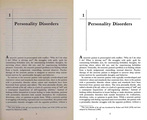

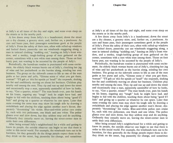

The result is pictured below (before and after):

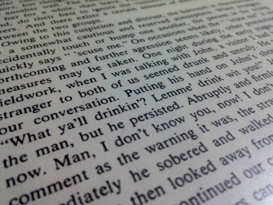

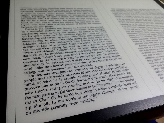

And here is the book on the monochrome e-Ink screen:
Better contrast, clean background, nicely-shaped letters.

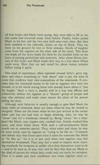

Here's another example from a Psychology manual. Notice how the text coming through from the other side of the page is hone and how the coffee spot at the bottom is less visible in the final output:
