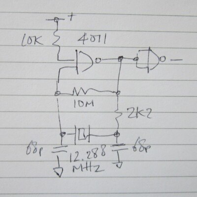

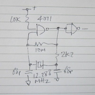

I don't have any 'HC04 inverters (that I can find), so I've based it on a couple of the NAND gates
in a 74HC4011.
Here's the circuit. I'm just guessing that the crystal might be cut for a load capacitance of
something like 30pF. So the load caps might have been better as 56pF, but I had some 68pF, so went
with those.

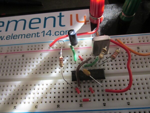

The Prototype
Here's what my prototype looked like on a plug-in breadboard
Fortunately, it started up and ran nicely.

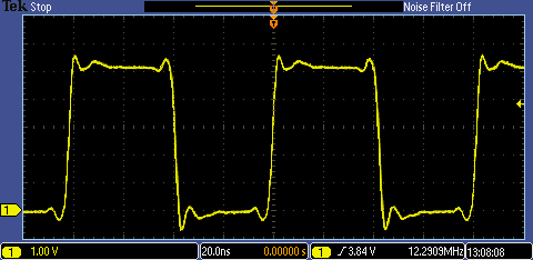

Here it is on a 5V supply:

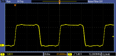

It's less symmetrical on 3.3V, though I don't suppose the FPGA would mind. The frequency is much
more accurate on 3.3V, though still a little high, so I'll go with that one since the FPGA IO is
also 3.3V. There's a little more jitter, but it looks to be less than half a ns (can't really tell
any better than that with my scope, anyway). If it were a problem, I could always give it to one
of the PLLs in the FPGA to clean up.

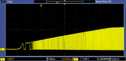

This is how it behaves when the power comes up.
It starts quickly enough, when the supply gets up to about 1.2V. The subsequent ramp up that you
see is simply the smoothing capacitor in the bench supply output charging.

    Correction: for some reason I wrote 74HC4011 in the blog and 4011 on the circuit, when what I actually used was a 74HC00. Sorry for any confusion.

    jc2048 over 5 years ago in reply to Jan Cumps
    Yes, the left gate is being used as an amplifier. The 10M resistor does the biasing.
    I did wonder if it would work with the NAND gate, as these kind of circuits usually show an inverter, but it was fine with the unused input tied to the rail.
    Probably not a good idea to try making the FPGA do it.
