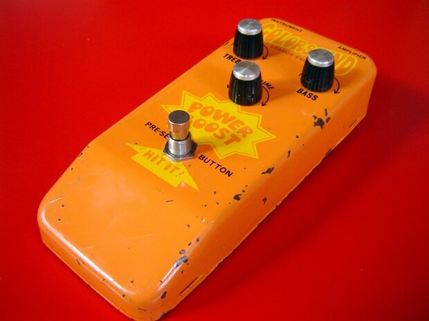

The power boost was first launched in 1968 and since then has garnered almost mythical status. For many years it was a secret weapon, that almost went under the radar of many musicians, people wanted to know how these tones and sounds were created, and a lot of musicians went on the search for this fabled effect pedal....... Their search led them to Denmark Street in London, and the home of Colorsound.... Macaris.
The 18v Power Boost was encased in a bright orange enclosure which did not go over too well in the US, so around 1971 (factory schematic dates 14.6.71) it was repackaged in a grey enclosure, changed to 9v power, and renamed the Overdriver. There was also a version made for Vox in a different enclosure (Tone Bender Mark III case) around this time, in the same grey color, but using the Power Boost name. The 18v Power Boost version was still being made up until 1972. The 9v circuits was similar to the 18v circuit, just set up to run on a lower voltage, but it also had more distortion when the drive knob was set to maximum. Both the Power Boost and Overdriver were housed in the original Tone Bender style, pressed sheet metal cases.

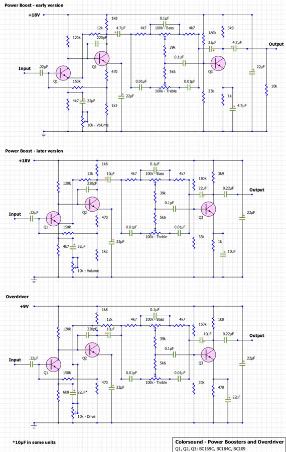

Now, onto the circuit, there are 3 schematics for this pedal, the first 2 are 18v circuits, the last one is a 9v circuit that was designed for the American market, the name was also changed to the Overdriver for the 9v version. The version I decided to make was the first early version. I distinguish the first 2 versions by the inclusion on the first version of a 10k resistor on the output. This was removed from the second version.... It's an easy way of identifying whether it's a 1st or 2nd generation pedal. There was for a very short period at the end of the 70's a 9v Power boost, but the general consensus is that these were purely 9v Overdriver circuits that were put into a batch of Power Boost enclosures, likely because they'd ran out of the Overdriver enclosures.

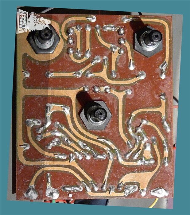

Being a huge Pink Floyd fan, and guitarist I'm forever trying to chase Gilmours tone, and obviously I have to have a power boost in my arsenal of effects, It's for this reason that i decided to build my own. For my build i wanted to recreate the PCB layout as close as possible, to enable me to do this i had to get as many gut shot photos as possible, thankfully there are plenty on the web, and Electric Warrior over at the DIYStompboxes forum helped by supplying photos of his own unit. Here's a photo of an original PCB. When  I designed my board I originally recreated the schematic in Eagle, and tried to get the layout to follow the same pattern as the original board.... My first eagle effort is beside the original. There's not much difference, and it all worked fine apart from the lonely ground pad at the bottom which wanted to connect somewhere it couldn't get to. That was easy to remedy on the first build manually.

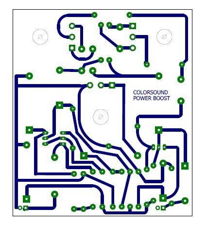

I built my first prototype pedal using this Eagle layout, and it worked a charm, exactly as it should. I used all brand new components, and it went together with not many issues. This first prototype was housed in a plain aluminium enclosure and was sold on to a friend on my Facebook at cost price. I still needed to build my own Power boost, but wasn't happy with the board layout.... I wanted it to look more like the original, so for this I employed the use of Microsoft Paint image

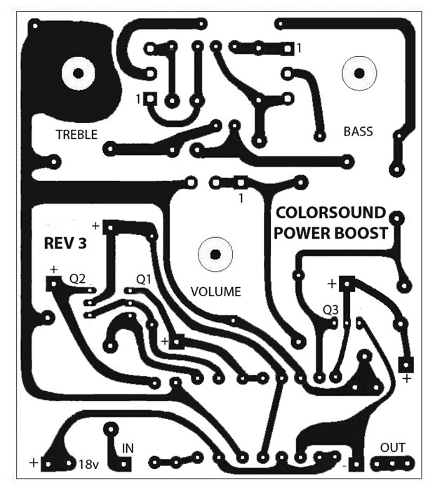

Yes, I loaded the image into paint and manually altered the Eagle layout to look like the original...... And this was the end result.
Following the completed design of my board layout, I had to etch it... For this I utilised the toner transfer method. I printed a mirror image of the layout onto some glossy photographic printer paper, and then basically ironed it onto the PC board blank. Once the board was etched, i populated it with NOS "Iskra" resistors, Mullard "Tropical Fish" capacitors, and new Vishay polarised capacitors. I also used the same transistors as the original, BC184L.... The end result was the board below
