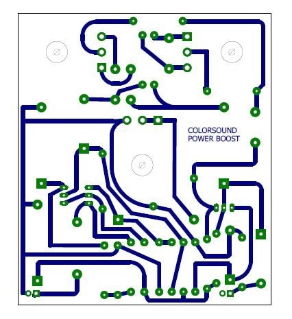

Being a huge Pink Floyd fan, and guitarist I'm forever trying to chase Gilmours tone, and obviously I have to have a power boost in my arsenal of effects, It's for this reason that i decided to build my own. For my build i wanted to recreate the PCB layout as close as possible, to enable me to do this i had to get as many gut shot photos as possible, thankfully there are plenty on the web, and Electric Warrior over at the DIYStompboxes forum helped by supplying photos of his own unit. Here's a photo of an original PCB. When  I designed my board I originally recreated the schematic in Eagle, and tried to get the layout to follow the same pattern as the original board.... My first eagle effort is beside the original. There's not much difference, and it all worked fine apart from the lonely ground pad at the bottom which wanted to connect somewhere it couldn't get to. That was easy to remedy on the first build manually.
I built my first prototype pedal using this Eagle layout, and it worked a charm, exactly as it should. I used all brand new components, and it went together with not many issues. This first prototype was housed in a plain aluminium enclosure and was sold on to a friend on my Facebook at cost price. I still needed to build my own Power boost, but wasn't happy with the board layout.... I wanted it to look more like the original, so for this I employed the use of Microsoft Paint image
Yes, I loaded the image into paint and manually altered the Eagle layout to look like the original...... And this was the end result.
Following the completed design of my board layout, I had to etch it... For this I utilised the toner transfer method. I printed a mirror image of the layout onto some glossy photographic printer paper, and then basically ironed it onto the PC board blank. Once the board was etched, i populated it with NOS "Iskra" resistors, Mullard "Tropical Fish" capacitors, and new Vishay polarised capacitors. I also used the same transistors as the original, BC184L.... The end result was the board below

I then got my designers hat on and plagiarised the internet and created my own decal for the enclosure......... Of course I had to use an orange enclosure, and I just loooooove 60's font. I have used the Colorsound name, but of course If I built one of these for someone else, i wouldn't as it's copyrighted, and a trade mark of Macaris. The decal is a water slide decal that I printed on from my ink jet printer. After I printed it, I then lightly sprayed some varnish onto it to prevent the ink from running when i put it in the water. Applied it to the enclosure, and then sealed it with about 5 coats of varnish. now all that's left is to test it........ video to follow.
