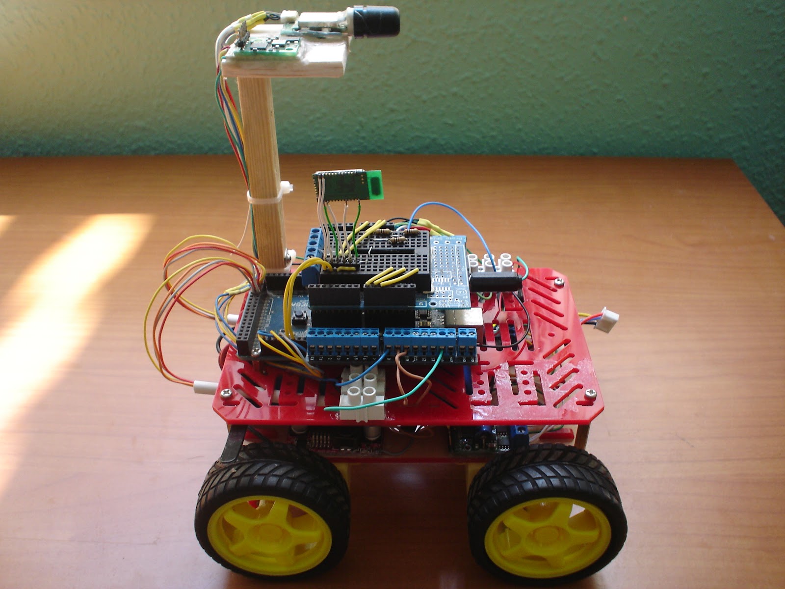

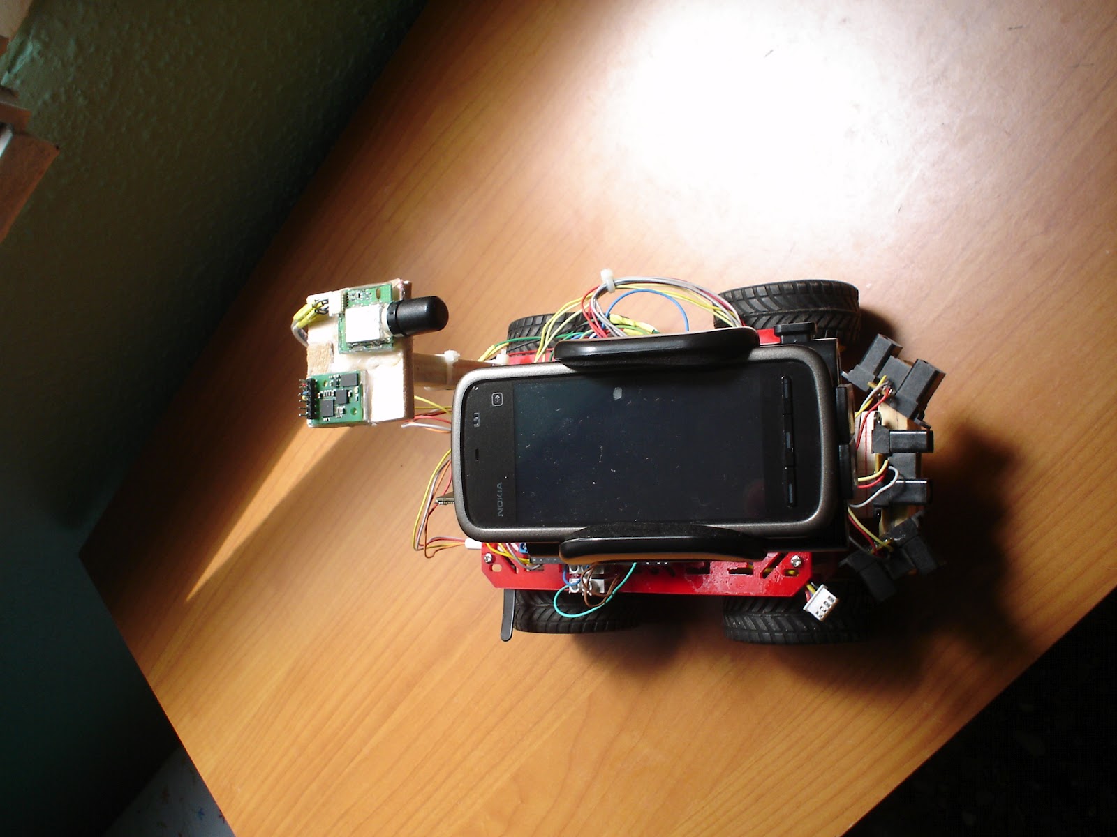

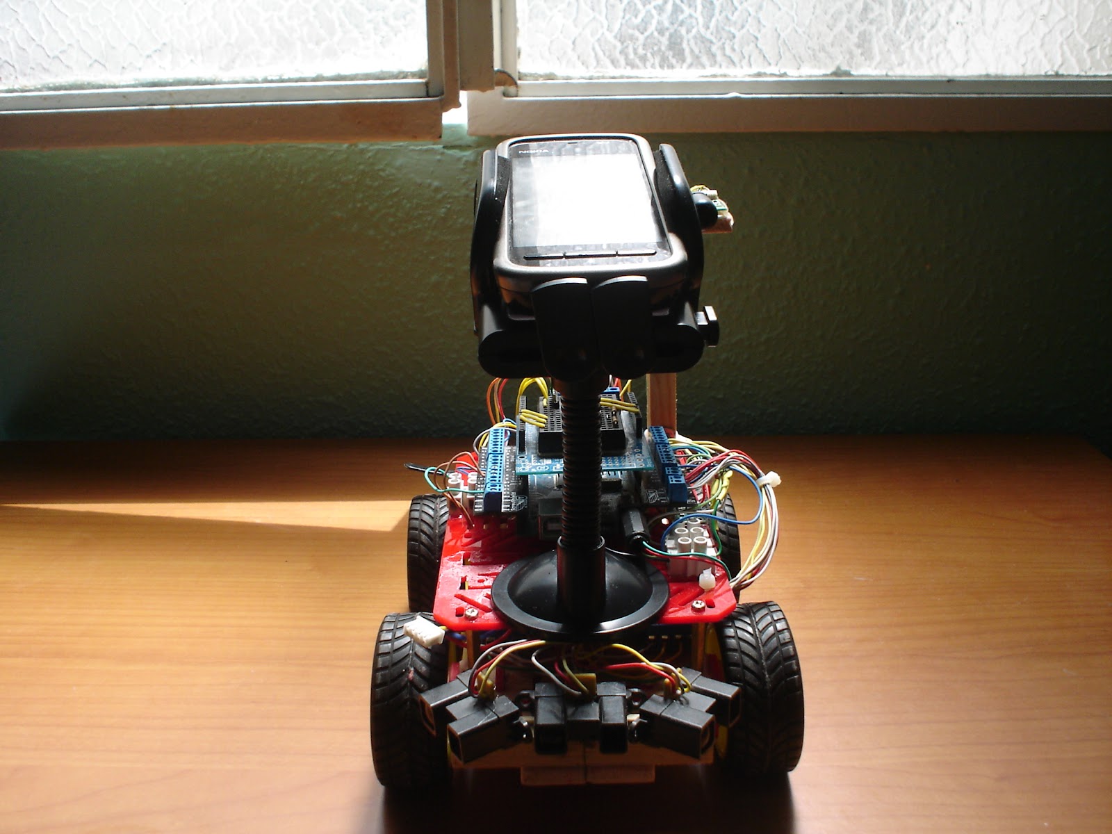

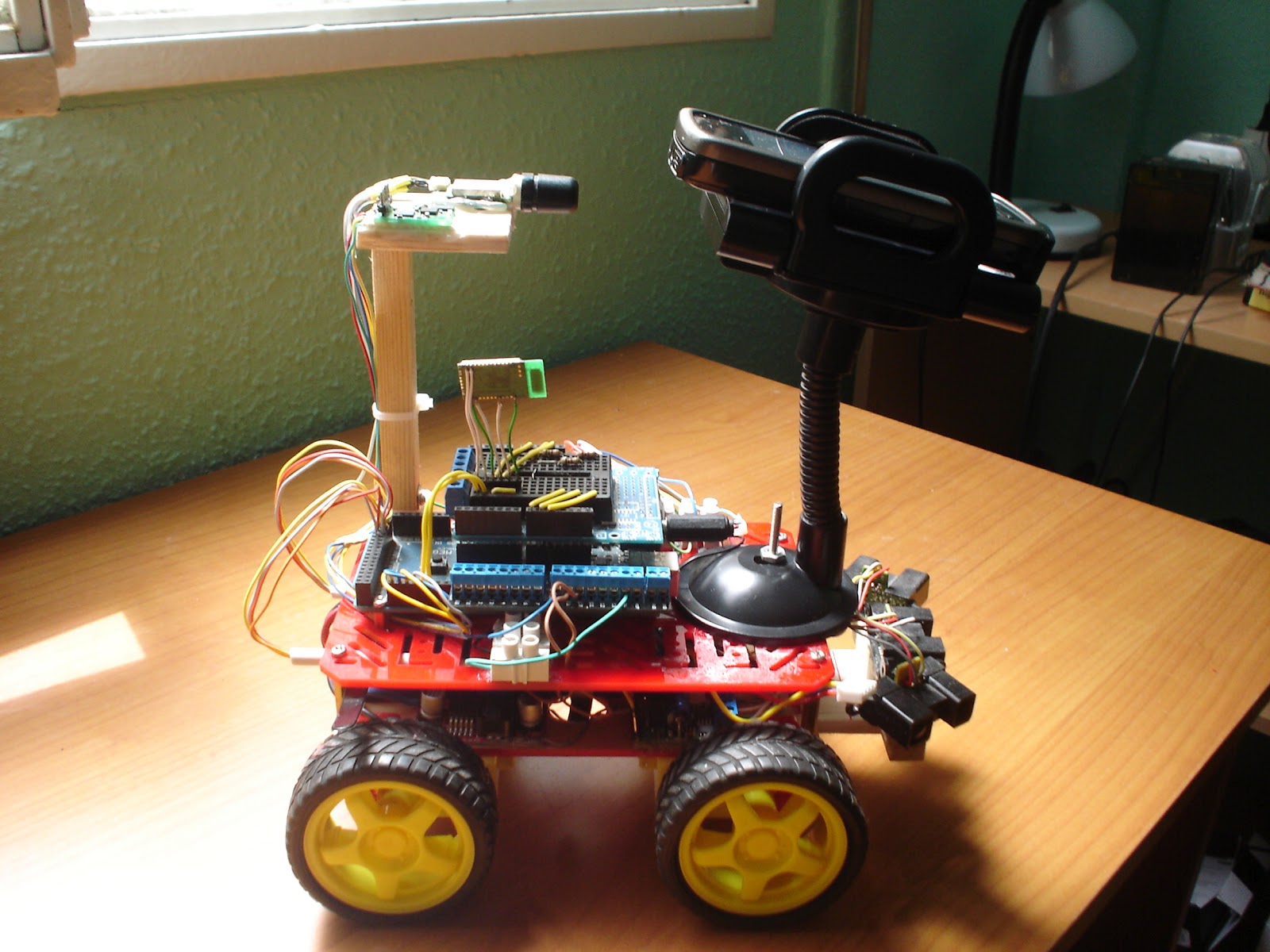

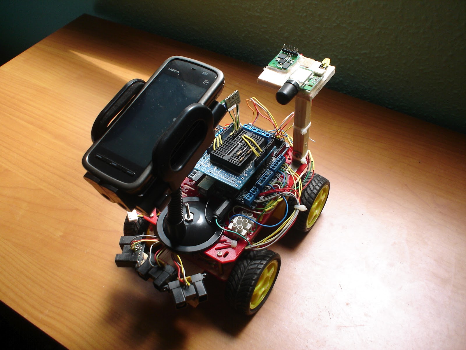

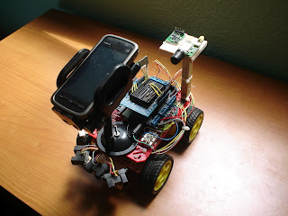

What is about the Project?
14WDplatform
1lipobattery
2buckconverter(* not strictly necessary)
1Arduino(I use Mega)
1BluetoothModule
1 GPS(not used in part one)
1 Compass(not used in part one)
1 MobileNokiaSymbianS60

2 H Bridge(in my case using twoH bridgePololu)
The first thingwe mustdo ismakethe receptionof data bytheArduino. we have toconnect our computertoArduino and program the serial communication. we mustbear in mind thatwe are going to sendseveral datathrough the serial portso it isimportantthatatthe time of makingthecommunication we have to have astart and anend character.
Keep inmind that inmy casewhen using anarduinomega, I have several serialcommunication portsso you can usethe library "NewSoftSerial" but the baud can not be veryhighas you runthe risk ofinformation loss. This projectworksat a speedof 9600baud
Arduinocode:

Oncethe data is stored in a array related to variable called"Acction" we can start the motor control, in this partI'll explain justhow it has to bebecause the reader may have another H bridge
if(Acction==16){
Adelante
else if(Acction==17){
Atras
else if(Acction==14){
Izquierda
else if(Acction==15){
Derecha
else if(Acciton == 167 | Acction == 0){
Stop
and tha´s it!!!we have motor control.
