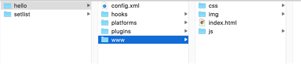

If we look at what this has created below we can see the directory hello which contains a configuration file (config.xml) and a www subdirectory, which itself contains index.html and some subdirectories for default image, css and javascript.
This 'skeleton' app is fully working (although it doesn't do much) all we have to do is to build and deploy it.

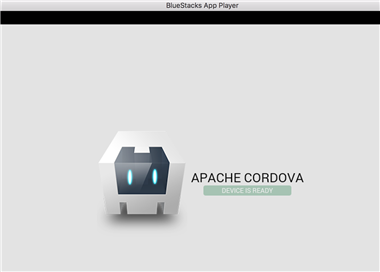

Another alternative is to use an Emulator on your computer - I have been using BlueStacks which works really well - for more details see http://www.bluestacks.com/
With Bluestacks running, loading the app is as easy as right clicking on the apk file, and taking the 'Open with Bluestacks' option. The app will then deploy to Bluestacks and can be opened - e.g.
Coding 'Hello World'

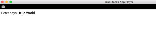

The above is the output from the default index.html page provided when we created our application - inspection of that file will explain how the above output is generated. for my app I want it to say 'Hello world' so I need to edit the index.html file accordingly . For example if I edit the file as follows ;
<html>
    <head>
        <title>Hello World</title>
    </head>
    <body>
        Peter says <b>Hello World</b>
    </body>
</html>
I now rebuild the app - i.e. cordova build android
Redeploying the app to Bluestacks I see.
Obviously this is a trivial an app as it is possible to build - but 'all' I need to do now is to write html (plus javascript, etc!) and I can quickly build deploy and test my app. IN other words, if you can write a webapp, you can write a mobile app!
