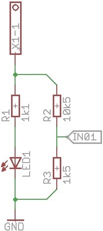

CPLD Controlled Door Lock - Input Circuit
oldmanraskers
oldmanraskers
25 Apr 2015
Input Circuit
The input circuit is very simple. Consider that 24V is present at the connector X1-1; this will allow 20mA to flow through LED1 and indicate there is an input present.  Approximately 2mA will flow via R2 and R3, thereby pulling the CPLD IN01 pin to 3V (the device can accept unto 4V).

    michaelkellett over 11 years ago in reply to oldmanraskers +1
    You're mixing up output drive currents and input currents. The MAXV will draw a tiny 10uA current on an input (unless you program a pullup current for that pin) so when Q1 is off you would expect to see…

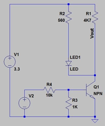

  • michaelkellett
    The MAXV will draw a tiny 10uA current on an input (unless you program a pullup current for that pin) so when Q1 is off you would expect to see 3.3 - (4700 * 10E-6) = 3.253V which is fine.
    When Q1 is on the CPLD input will be pulled down to about 100mV (depends on the device you use for Q1)
    The nice thing about this circuit is that the LED current is independent of the input to the CPLD, so the LED current is (3.3 - LEDvolts)/R2. A reasonable bright RED LED (Farnell 1814437) will drop about 1.8V at 10mA (unless you want to light up a whole room you really do not need 20mA - 2mA will be more than enough for indication).
    So we can work out R2 = (3.3 - 1.8)/10E-3 = 150R, and for 2mA you need 750R - so my standard value of 560 wasn't too far off the mark image
    MK

  • michaelkellett
    I think I would do it like this:
    Much less power wasted in the LED resistor and the input to the CPLD goes from low impedance 0V when button pressed to pull up to its own 3.3V supply. It will be less susceptible to noise and variations in the resistor values.
    If you will have long wires to the button something else might be needed.
    If you want to detect a 24V (or other voltage) signal then replace the button with an NPN transistor with a resistor from base to ground and an input resistor to the base, collector to R1 and R2, emitter to ground.
    By setting the input resistor correctly you can have almost any input voltage and the CPLD input is quite well protected.
    If the electrical environment is awful then add a capacitor from the transistor base to ground.
    You'll need to debounce the signals but you can do that in logic in the CPLD.
