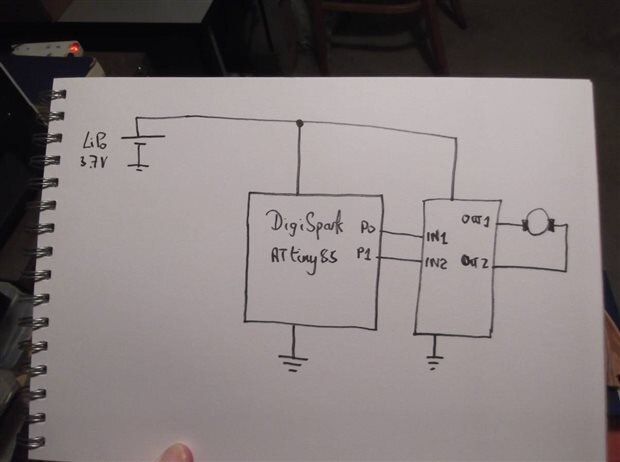

I have added an ATtiny85 microcontroller, mainly because that is the device I have been playing with recently and I only need a couple of digital outputs, plus a DRV8833 dual H bridge driver, using only one bridge, to control the DC motor. From my experiments with the ATtiny85 I have discovered that it needs at least 2.8V to work reliably so rather than use the existing 2 x AA battery module I added a 3.7V LiPo battery instead, ,just to give that little bit of extra confidence. It is a simple circuit and is shown below:

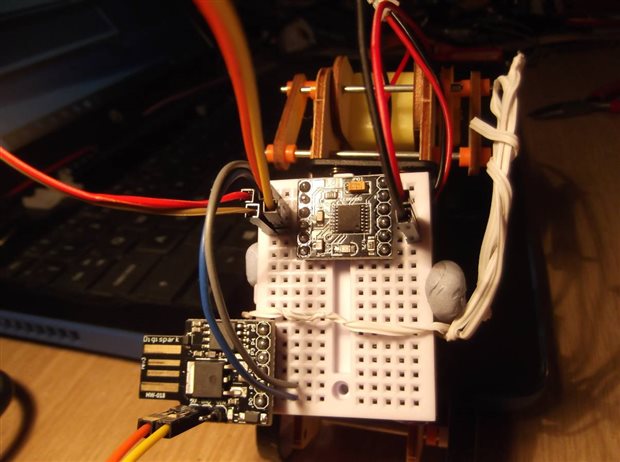

I have used a small protoboard to hold the ATtingy85 and DRV8833 PCBs during this initial development stage, as shown below. I can always make these connections more permanent if it seems to work out OK.

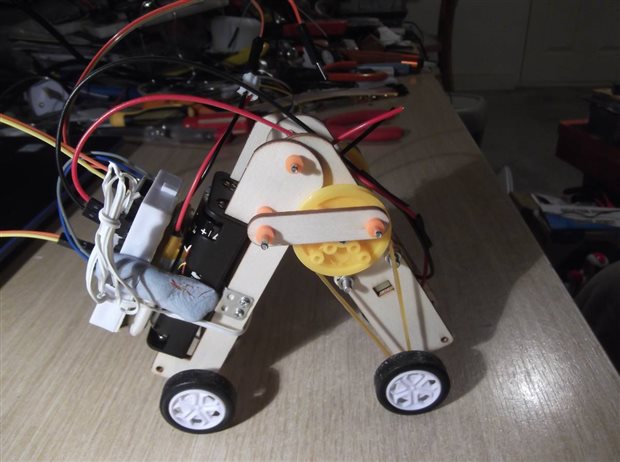

At present it is all just held together with Bluetac and a wire tie as illustrated in the picture below. Assuming all goes well I have plans to 3D print a framework for an updated Crawling Worm Robot.

I wanted to check that changing the direction of the DC motor would also change the direction the Crawling Worm Robot would move. I wasn't entirely sure that it would, but fortunately it does, as illustrated in the video below.
So I have made a step forwards in converting the Crawling Worm Kit into an actual robot - with a controller and (hopefully at some point) sensors as well. As mentioned above, I am planning to make a 3D printed framework for the Crawling Worm Robot to replace the wooden version and to customise it for the ATtiny85 controller and H bridge driver.
