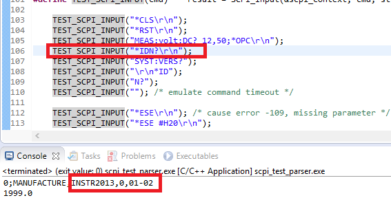

Here's a snippet of the test-parser example.
    TEST_SCPI_INPUT("*IDN?\r\n");
    TEST_SCPI_INPUT("SYST:VERS?");
    TEST_SCPI_INPUT("\r\n*ID");
    TEST_SCPI_INPUT("N?");
    TEST_SCPI_INPUT(""); /* emulate command timeout */
    TEST_SCPI_INPUT("*ESE\r\n"); /* cause error -109, missing parameter */
    TEST_SCPI_INPUT("*ESE #H20\r\n");
The TEST_SCPI_INPUT() macro is a wrapper around the lib's parser function
#define TEST_SCPI_INPUT(cmd)    result = SCPI_Input(&scpi_context, cmd, strlen(cmd))

This is the output of my first debug session:
Most likely this library will be a fit for my purpose. At least functional.
I'll have to check if it doesn't use malloc(), UNION or other constructs that aren't allowed by MISRA. The first checks look promising.

And here's the output (errors are expected - the program exercises fault handling too):
**Reset
meas:volt:dc
        P1=12
        P2=50
0;MANUFACTURE,INSTR2013,0,01-02
1999.0
**ERROR: -109, "Missing parameter"
**SRQ: 0x64 (100)
**ERROR: -113, "Undefined header"
-109,"Missing parameter"
**SRQ: 0x60 (96)
**ERROR: 0, "No error"
-113,"Undefined header;IDN?"
96
33
0
meas:volt:dc
        P1=0.01 V
        P2=DEFault
0
meas:volt:dc
        P1=1.112254449840
        P2=1.955364798282
0
meas:volt:dc
        P1=DEFault
        P2=1e-005
0
meas:volt:dc
        P1=1e-005
        P2=1.955364798282
0
TEXT: ***a***
TEXT: ***a a***
TEXT: ***aa a***
TEXT: ***aaa aaaa***
**SRQ: 0x44 (68)
**ERROR: -200, "Execution error"

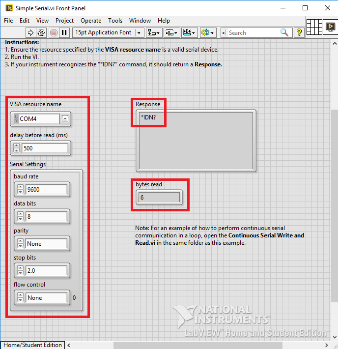

I'll implement a serial interface on my test device with USB. And then I'll develop a single callback that supports *IDN?.
If I have that working, I can try to set up a conversation with LabVIEW.
(note to self: there's a test program in D:\Program Files (x86)\National Instruments\LabVIEW 2014\examples\Instrument IO\Serial\Simple Serial.vi)

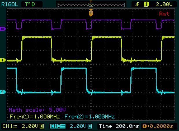

    I've finished what I wanted to have. Full control of PWM signals with LabVIEW.
    The design can independently control 7 double PWM modules.
    Each module can have in-sync or complementary signals. The duty cycle of both signals can be controlled independently.
    I can set a deadband on either of the two signals - with different times.
    In LabVIEW, you can select one of the seven PMW modules, set the parameters and configure the device.
    Here's a capture:
    The signals on the scope are the two outputs of PWM module 1.
    Both are at 50% duty cycle.
    There's an asymmetric deadband applied. It's longer for the rising edge of the blue signal. (The purple trace shows the deadband).
