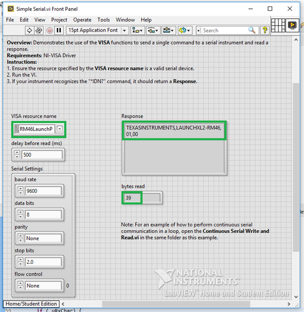

In the previous blog, I stopped when LabVIEW and the microcontroller were able to perform a mock conversation over USB.
LabVIEW sent us an *IDN? command, and the Hercules just echoed that command back to LabVIEW.

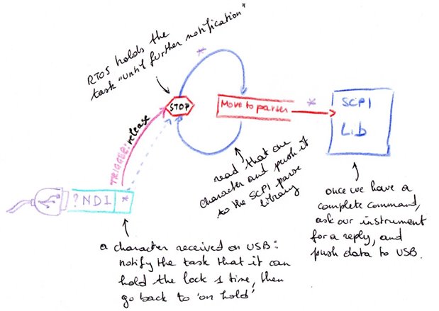

For a meaningful conversation, we have to do three things:
  • send the command string we received from LabVIEW to the SCPI parser library
  • inform the parser library how and what it should reply on an *IDN? command.
  • learn the library how to reply via our USB port
Sending the string to the library is done for each character, as soon as we've received it. I'm using a freeRTOS interrupt notification mechanism.
I have an RTOS task that sits ready forever to consume characters from the USB port. It doesn't run.
In the Read interrupt handler for my serial comms module, I have put a 'wake-up' call. It notifies the halted task that it can continue.
The halted task proceeds, moves the character to the parser input, and goes back to sleep until the next interrupt (the next character).
That's a step up from my initial design, where I was sleeping and polling for input.
Initially I implemented a buffer to compose a string from the input characters, and send that concatenated string to the parser. But the parser has its own buffer mechanism.
I've changed my code to send each character to the lib directly. Whenever it determines that it received a complete command,it sends the reply via USB.
If this approach turns out to be too naive or too costly, I'll revert to buffering the data before sending it.
As explained in the side note above, the function normally halts at ulTaskNotifyTake(), waiting to be woken up by the USB Read interrupt.

The USB Read interrupt service routine just unlocks that task by sending it a notification vTaskNotifyGiveFromISR().

If you don't have LabVIEW, don't worry.
You can use PuTTY (or another terminal program) to run SCPI over USB.
Here's the result of running the *IDN? command, while connected at 9600, 8, 2, N:

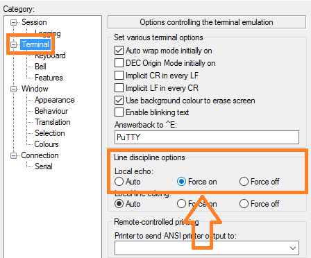

You won't see the commands you type, because SCPI doesn't echo them back.
A simple trick is to temporarily turn on local echo in PuTTY, so you see your input while you type it.
Don't get confused by that 'local echo' edit mode: even though it seems you can correct your entry while typing, that's not true.
All characters are directly sent to the USB port as you type them. And there's no error handling (yet) on the controller side.
