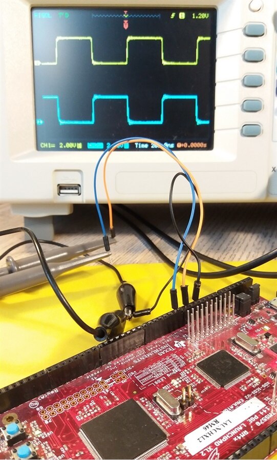

Compile, load to your RM46 LaunchPad and connect with a serial terminal program using 9600, 8, 2, N
Put an oscilloscope probe on J11 16 and 18. You'll find two complementary 1MHz PWM signals.
Submit these commands in putty to switch them off and back on:
PWM1:STATe OFF
PWM1:STATe ON
