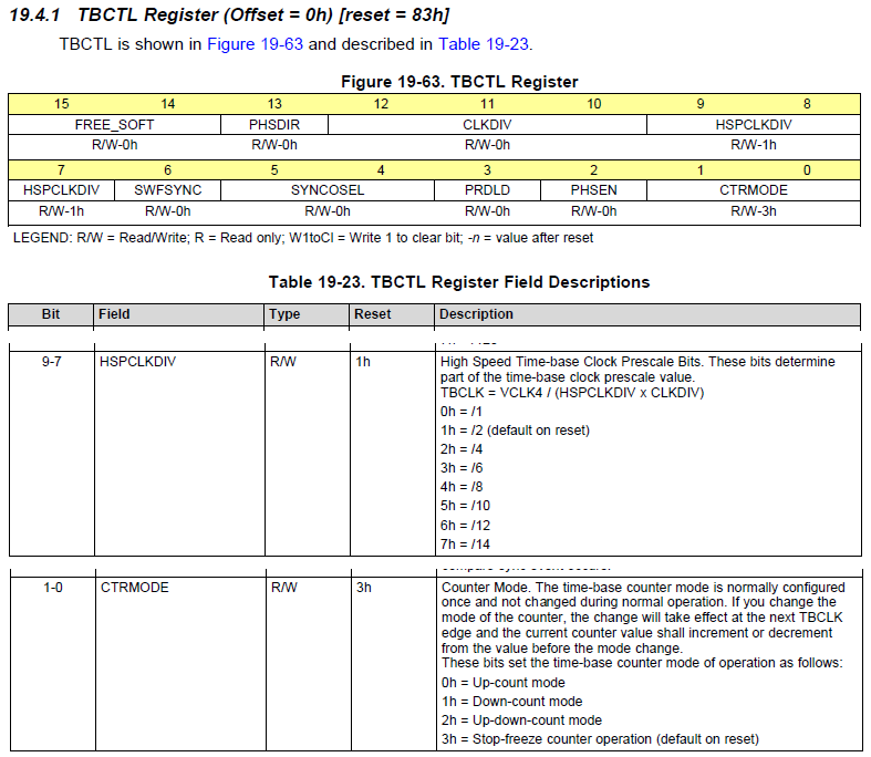

TBCTL is a 16 bit register that drives the following PWM behaviour (and more, that I don't discuss here):
Bit 9 - 7 are the high speed clock divider bits. A few examples
0b111: /14
0b001: /2
0b000: /1
Bit 1 - 0 indicate the counter mode. We'll use these two in our example:
0b00: normal up count
0b11: freeze counter

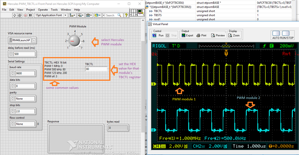

The LabVIEW Design
This version of the LabVIEW panel has two user editable controls.
There's a dial that allows you to select PWM module 1 to 7.
When you run the LabVIEW process, it will talk to that PWM module of your Hercules LaunchPad.
The second control is an edit box where you can type the hexadecimal value of what you want to write to that PWM module's TBCTL  register.
For convenience, I've added a table with some useful values next to it.
Use this edit box together with your controller's technical reference manual.
The LabVIEW program here is a great tool for you to better learn your controller's PWM module.
You can type in any value you like (better base it on the instructions in the TRM image ), and beam them directly into the register.
You can attach a scope and see the results.

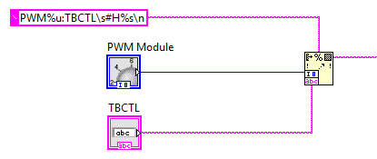

Here's the very simple LabVIEW block diagram.
The string constant holds the following value:
PWM%u:TBCTL\s#H%s\n
That is sent into a Format Into String block, together with the values of the dial and the edit control.
At the output of the block, you'll get:
PWM2:TBCTL #H80\n
That is sent off to the Hercules LaunchPad over USB.

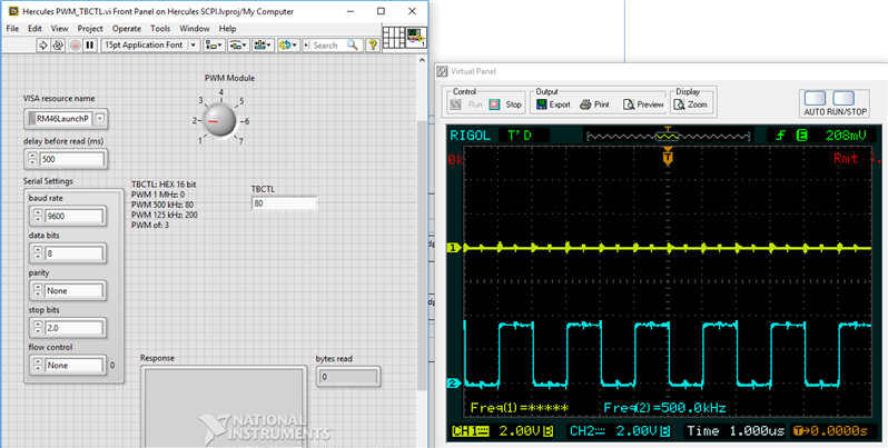

Let's see how the outputs of PWM module 1 and 2 look lik when we send a few commands.

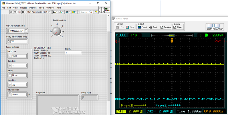

After sending 0x3 to both modules (both off):
After sending 0x80 to PWM 2 (500kHz):

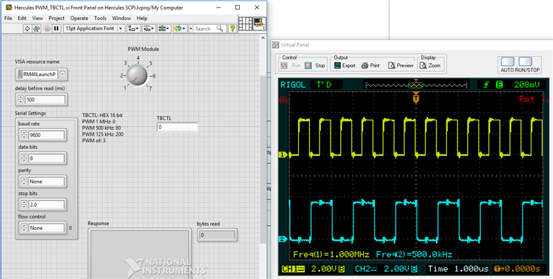

After sending 0x0 to PWM 1 (1MHz):
It's easier to understand why 0x03 switches off the PWM signal and why the other magical HEX values do what they do if you know the layout of the register we're addressing. Here are the relevant bits explained.
Source:  http://www.ti.com/lit/pdf/spnu514
