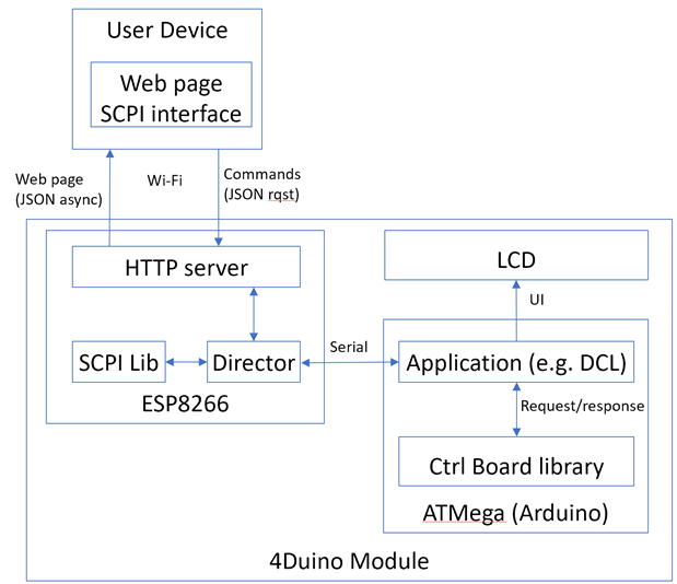

At least in my imagination, I can see this as the front-end for a number of headless instruments, but that's much further down the road.  In a separate post I describe my choice of DAC, ADC and Op Amp.

Off-board controls are all on 'Side A' of the isolation, with power provided by the DC/DC isolator.  I want to be able to drive this from a suitable MCU so I'm not providing header connectors for any specific device.  I will use my 4Duino because I have it to hand and I'm more familiar with Arduino coding - I've covered the 4Duino elsewhere - here and here -  so I won't go into much detail but the advantages I see here are:
  • Built in touch-capable LCD so no separate powering or control circuitry required
  • Built in ESP8266 for Wi-Fi access so no need to connect to a PC for remote control.
  • Built in SD card for data storage (e.g. logging profile data for off-board processing)
I have also made provision for a momentary power button to toggle the board output on/off - using a momentary button means I won't need to have any complicated syncing routing between any touch button on a screen and the button state which would be needed if it was a latching type.  A rotary encoder will provide an alternate input mechanism for selecting options or entering control values.  These are manual controls to supplement a touch interface.
There is a 14-pin header on the board for connecting power to the external MCU along with the control lines to/from Digital/Analog/GPIO pins.  The design schematic shows how I intend to connect the 4Duino to the board; the global labels on connections 14 - 7 go straight to the isolators.

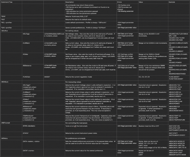

    I'll elaborate a little on the firmware / software. I'm still drooling over your hardware approach - so well designed. The eload has a core API. Representing all functions of a programmable load. I also…
  • jc2048
    jc2048 over 6 years ago +5
    I didn't know whether to comment on this or not. I don't have direct experience of this kind of analogue electronics, so best to regard these comments as 'thoughts' or 'musings' rather than advice. They…
  • fmilburn
    fmilburn over 6 years ago +4
    Very nicely done
    Jan Cumps over 6 years ago

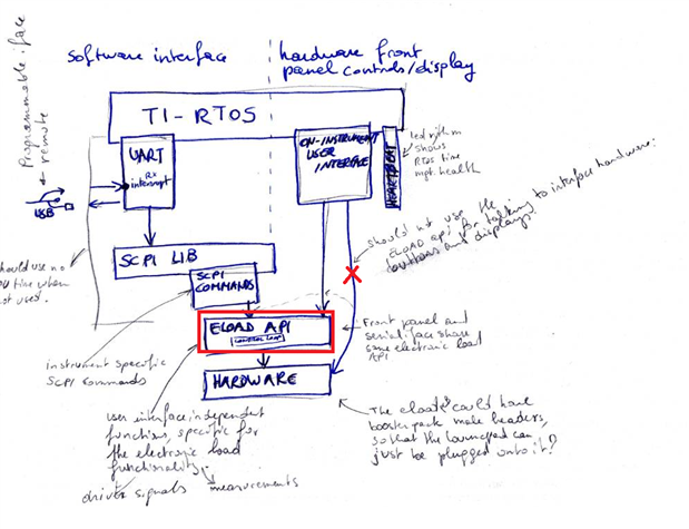

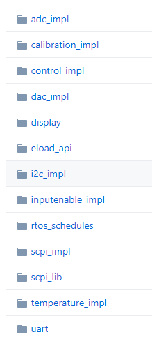

    I also provided low level access to DACs and ADCs. To allow a client app to define functionality I didn't think about. For hacking, For tuning ...
    All these "public" calls are defined in a single api header file.
    Both SCPI interface and user interface (only LCD) use the instrument API.
    I did not make a reusable user interface module. It's very basic.
    In my concept, I provisioned an option that the hardware user interface is allowed to talk to the instrument hardware directly if required. Forr speed or user experience reasons.
    It's not used though. I only have a display and all info needed is retrieved from the instrument API.

    I'm not a good enough C programmer to go that route at the moment, but I may be forced to as my 4Duino is rather memory constrained!  I've already made a start on some of the software side:
    It's embryonic: I created a dummy DC load application and I'm able to drive it via SCPI commands from a web page served up by the ESP8266.  I'm using the ESP8266 as it offloads the SCPI feature from the ATMega as the ESP module has shed loads of memory in comparison! I've attempted to create a useful set of commands and syntax based on the SCPI manual (and looking at DCL instrument guides.)  It all works but I haven't gone down to the hardware DAC/ADC level - I can set/read V, I, R, P, set and save configuration, turn on/off and so on - and it can be driven from a PC, iPad etc.  As I say, embryonic and I'd planned to provide for loading and running of a script at the user device but what I really need is to evolve it and provide the  ability to hook into something like Labview.
    My command tree (hopefully visible when clicked!):
    I was going to make a video to attach to this post but it got long enough. I will be looking through your libraries to work out the best way of developing a more advanced instrument interface.
