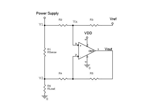

Differential Amplifier, Common Mode Limit.
So let’s define a few terms:
R2 = R4 and R3 = R5.
RSense << R2 and R3.
Vout = (V1 – V2) x (R3 / R2) + Vref.
G = R3 / R2; Gain of Difference Amplifier
VDM = V1 – V2; Difference Mode Input Voltage to Different Amplifier.
VCM = (V1 + V2)/ 2; Common Mode Input Voltage to Difference Amplifier.
VOH = Maximum High Level Vout of OpAmp. (From datasheet)
VOL = Minimum Low Level Vout of OpAmp. (From datasheet)
VCMRH = Maximum High Level Common Mode Input Voltage of OpAmp. (From datasheet)
VCML = Minimum Low Level Common Mode Input Voltage of OpAmp. (From datasheet)
So the VDM range will be:
VDM > (VOL-Vref)/G and VDM < (VOH – Vref)/G
And the maximum applied voltage will correspond to the OpAmp maximum common mode input VCMRH:
V1 < VCMRH (1 + 1/G) + Vref.
So for an OpAmp with 5V rail, Gain of 50, VOH 5V, Vref 2.5V and VCMRH 3V:
The output will saturate when VDM = (5-2.5)/50 = 50mV or full scale for a 50mV shunt…
…and the maximum input supply voltage will be 3 (1 + 0.02) + 2.5 = 6.52V.
If we want to operate a high side current shunt in a high voltage motor drive, say ±400V then the common mode range of a differential amplifier does not help.

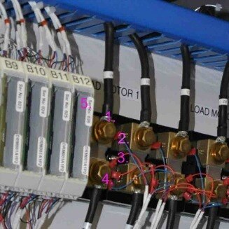

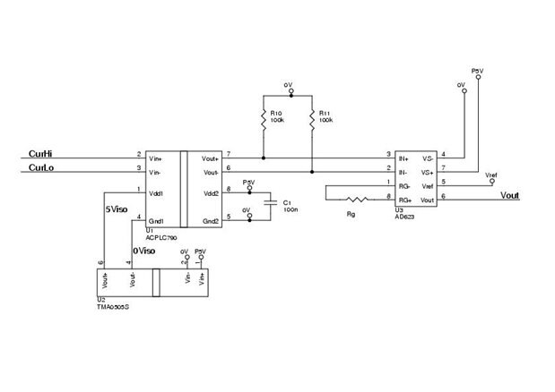

The Agilent ACPLC790 is an isolation amplifier designed for use with current sense resistors in high-side applications. The circuit above forms the basis of the isolation amplifiers (item 5) in this test stand:
The input/output barrier has a specification of 1230 Vpeak working insulation voltage.
The test stand instrumentation operates at 5V referenced to 0V and the isolated side of the amplifier is powered from a DC-DC converter U2 with an insulation working voltage of 1000 Vpeak, which sets the common mode limit of the module in the test stand.
Contact cscltd@btconnect.com for more information on this isolation amplifier. It is 2 channel, current and voltage, suitable for phase parameter measurements. Or put a query in the blog.
