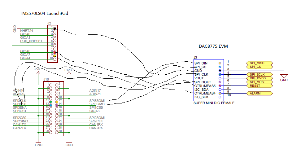

Connections
The Hercules is one of the smallest of the family, a TMS570LS04. I use this because it has all peripherals on board to do this exercise.
It's also my favourite microcontroller. We have a history together.
I'm using two GIO pins for the nRESET (GIO A.6) and nALERT (GIO A.7) signals. The SPI is served by the Hercules' SPI #3.
This choice is because I'm using a LaunchPad, and these pins are easily accessible.
DAC EVM PINSignalLaunchPad PINSignalLogic Analyser Signal
1SPI DIN (MISO)J10.12SPI3.SOMI1
2SPI nCSJ10.13SPI3.nCS03
3GNDJ2.1GNDGND
4SPI CLKJ10.11SPI3.SCLK0
5VDUTncncnc
6SPI DOUT (MOSI)J10.14SPI3.SIMO2
7nRESET inJ2.8GIOA.64
8ncncncnc
9nALARM outJ2.9GIOA.75
10ncncncnc

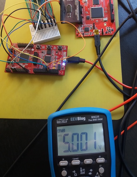

I've connected a volt meter over output A of the DAC board to validate behaviour.

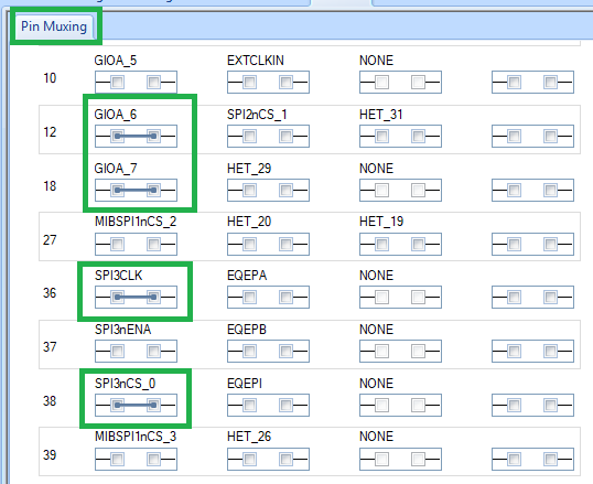

Configure Hercules Peripherals
As usual for this controller family, I configure peripherals and drivers with the HALCoGen application.

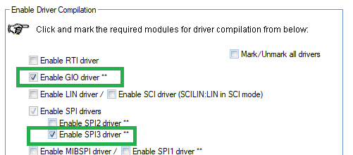

Drivers and PINMUX
I'm using the GIO driver for the nRESET and nALARM signals. SPI3 is the SPI port of choice.
Take care that alll signals that require MUX setup are active (on the TSM570LS04 they are all active by default. If you're using another Hercules, please check).

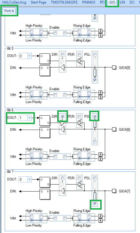

GIO
GIOA.6 is entertaining nREST. Set it as an output port, dafault to 1.
GIOA.7 listens to nALERT. Set it as an input port. Set the pull-down resistor to prevent the pin from flapping in the breeze.

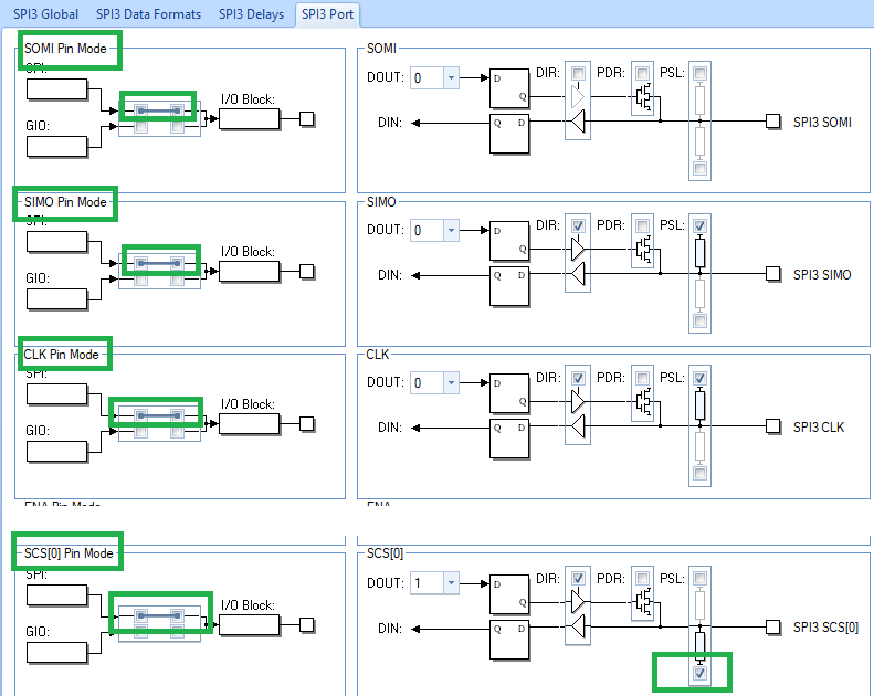

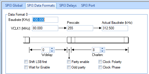

SPI
In the data format block, you define the speed (you can up the speed in real life. I'm using a breadboard so I'm restricting it to 321.5 kBaud) and the SPI word length.
This is also where you can define the clock polarity and phase.
In the Port block, you set the functionality of the SPI pins. I've set all that are used to SPI, all the rest to GIO.
To avoid bogus info in the nCS line, I've set the pull-down. Without thit, I get runt pules (same with MISO).
This may not be neccessary when you'e using a PCB instead of a breadboard and patch wires.

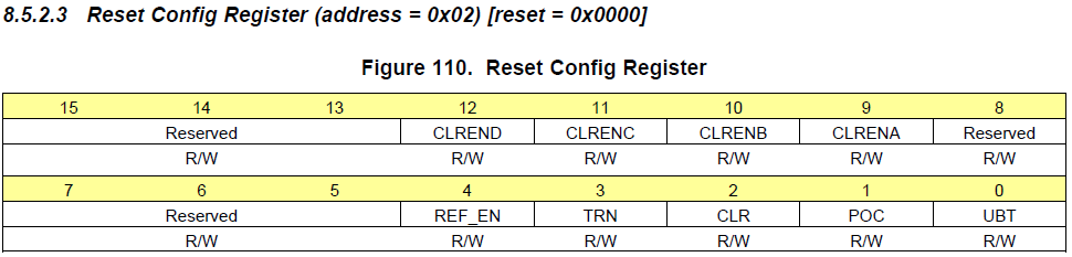

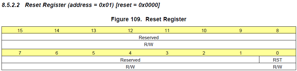

Next step is a software reset.
    // reset
    TX_Data_Master[0] = 0x01;
    TX_Data_Master[1] = 0x00;
    TX_Data_Master[2] = 0x01;
    /* Initiate SPI3 Transmit and Receive through Polling Mode */
    spiTransmitAndReceiveData(spiREG3, &dataconfig1_t, 3, TX_Data_Master, RX_Data_Master);

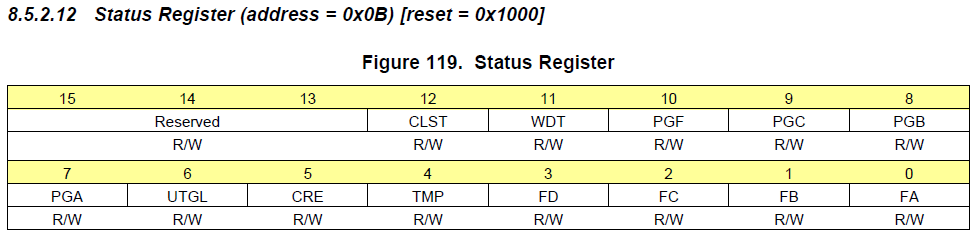

Then a validation of the communication by writing the user bit and reading it back:
    // toggle user bit
    TX_Data_Master[0] = 0x02;
    // read user bit
    TX_Data_Master[0] = 0x8b;
    TX_Data_Master[2] = 0x00;

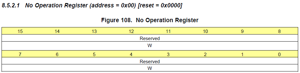

    // nop should return user bit
    TX_Data_Master[0] = 0x00;

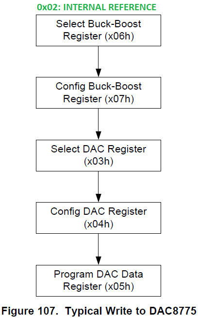

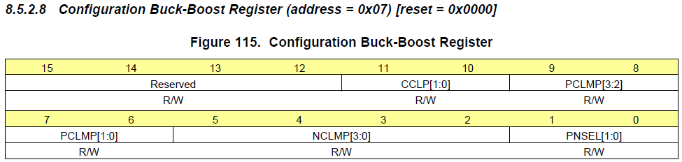

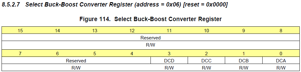

Select and configure the Buck-Boost module:
    TX_Data_Master[0] = 0x06;
    TX_Data_Master[2] = 0x0f;
    TX_Data_Master[0] = 0x07;
    TX_Data_Master[1] = 0x06;
    TX_Data_Master[2] = 0x1f;

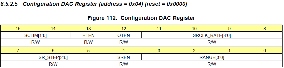

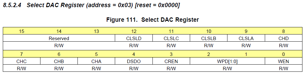

Select and configure the DAC output
    TX_Data_Master[0] = 0x03;
    TX_Data_Master[2] = 0xf0;
    TX_Data_Master[0] = 0x04;
    TX_Data_Master[1] = 0x10;
... and finally set the output value.
    TX_Data_Master[0] = 0x05;
    TX_Data_Master[1] = 0x08;
    TX_Data_Master[2] = 0xff;

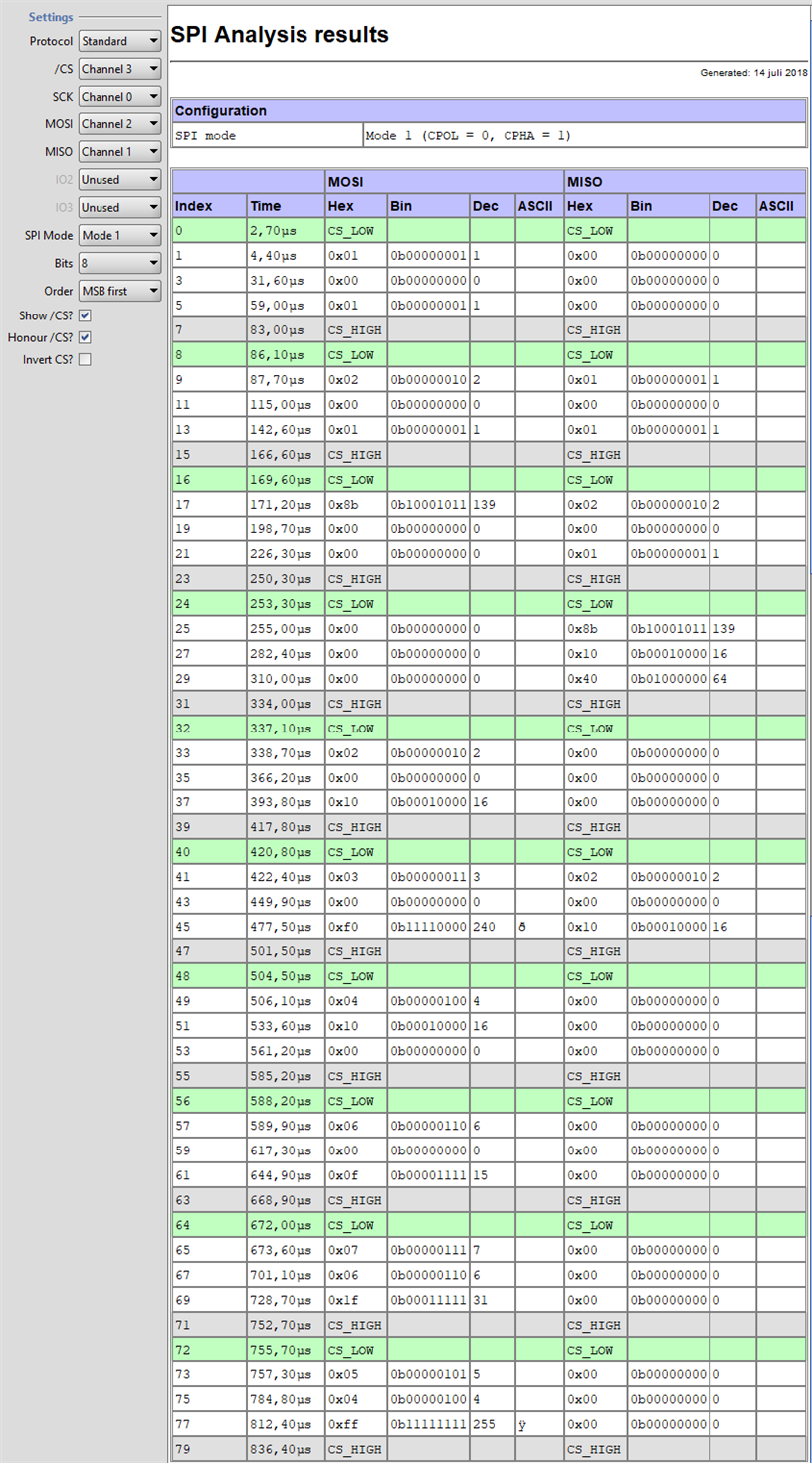

action shot of writing 0xffff to register 0x05
Below is a capture of the sequence. Note that when I took the capture, I had the Buck-Boost and DAC configuration parts switched around.
That's not good, because I enabled the output too soon (when writing register 0x04).
In the next posts I'll review the DAC's functionality.
