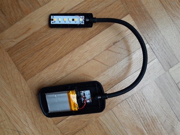

Hardware teardown

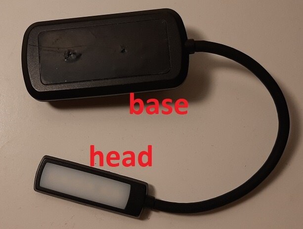

The image below shows the lamp itself ( Those marks over the rubber were caused by me before opening). Also, In order to make it easier for the description, I called the parts: head and base.

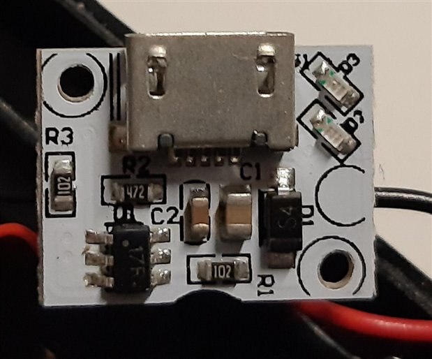

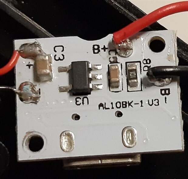

Base PCB
The base PCB basically provides regulated 3V3 for the head PCB. The circuit will not be detailed but it is in short a regulator and a Li-Ion charger controller.

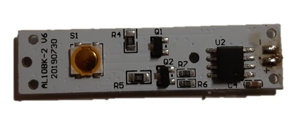

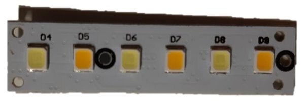

Head PCB
Finally, here is where the job really needs to be done. As you can see, the circuit is as simple as expected.

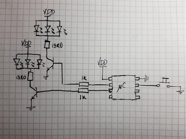

Drawing the SCH
Handed with a multimeter, it didn't take long until I could figure out how the connections were made. The figure below shows how these connections explicitly. note: although I wrote uC over the IC, it's was not necessarily an MCU.

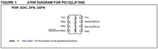

Now, the circuit is completely known and something can be done about it. In a quick look, I realized that I  could find some MCU that has a pinout compatible ( power pins and GPIO functionality for the LED and the button ) with the uC and then add some firmware and have it working with everything I wanted. After a quick search, I found the PIC12F1840 (see below) which matched the pinout (also functionality) perfectly.

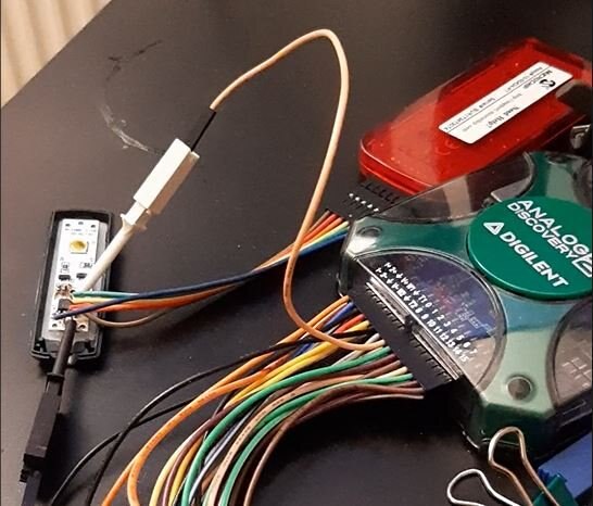

The Dev setup
As the MCU was delivered I just needed help from a hot air gun to remove the old controller and put my MCU in there. I also needed to solder a cable so that I can connect the programmer. The picture also shows an Analog Discovery 2 (AD2) which I used to simulate a button, this way I didn't need to press the physical button every time I wanted to test something, and actually, the real button was mapped to a pin used by the debugger which makes it useless in debugging mode. The AD2 was also used for checking the PWM generated to control the LEDs. Lastly, regarding the firmware development, I used the MPLABX IDE.

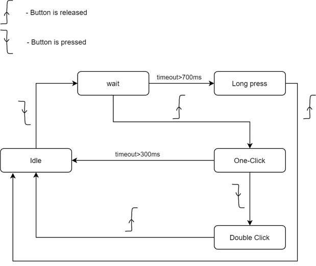

Since we already know the hardware, we can then think about the code structure, and in this regard, the manner I found to overcome the limitation of having only one button to control the whole system was to detect more than a single button click event. So I defined three events for the button: One-Click, Long Press, Double Click. Those are the events commonly captured by a smartphone as well.
About the environment
I made use of the MCC ( Microchip Code Configurator ) to configure the hardware as I needed for this project, the timers, clock, GPIOs, and so on.
The Button behavior
  • One-click: Changes the light temperature. If the light is off it simply turns it on.
  • Long Press: keeps changing the Brightness until the button is released
  • Double click: Turns off the light

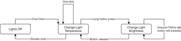

Now that we know how everything from the perspective of usability, we can now think in terms of code. In order to make it easy to implement the code, let's make some representation for parts of the system. First,  as the button is going to generate particular events, we can think of a state machine like the one drawn below:
Then, we need another state machine from each we can have the events generated by the button clicks. The drawing below represents the button subsystem

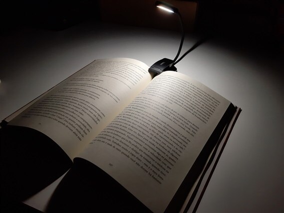

    That looks like a very useful modification. There are two other problems I find with such lamps though:
    1. with smaller books you tend to end up with more curved pages on one side and more flatter pages on the other so with a single lamp you tend to end up with more specular reflections on one side and  more diffuse reflections on the other. It perhaps needs two light heads which can be adjusted independently.
    2. I can never get the clamp to sit well on the page, especially for the first half of a paperback book when it tends to be located on the flimsy more curved left side of the book ( in order to allow you to still turn the right hand pages over ). Alternatively you clip it at the next chapter on the right side allowing you to turn a chapter's worth of pages before readjusting, but then you tend to get the hot spots where it has now distorted the page...

    I took some books to make some checks.
    • Book 1 ( in the picture): Old book with pages softened by the time
      • Keeping the book light close to the middle and adjusting somehow, gave quite a uniform result.
    • Book 2: new, hardcover book.
      • Here, the effect you described about the curved pages was totally visible and the readability was compromised.
    • Book 3: new, softcover but bigger ( width x height)
      • In this case, the turned pages were not a problem but the illumination until the end of the page was not good anymore. Maybe I didn't adjust that well.
    That's how I have been doing... and putting the light in the middle between pages on the left and right. I really like the idea about the double independent lights, I should give it a try, thank you.
