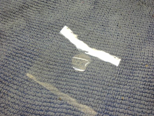

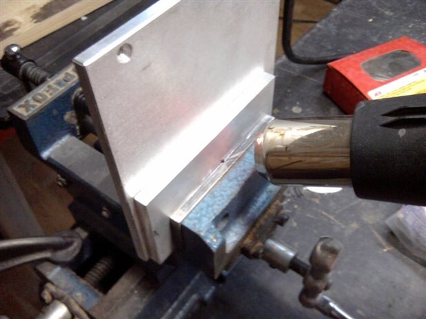

Here's a drop of acetone (available at any home improvement store) on top of a ~2"x2" square of mylar. A similar sized piece of vinyl was cut and placed on top. This spreads out the acetone in a beautiful, thin layer (if you've ever put a cover slip on top of a microscope slide, you know exactly what I'm talking about). Next, this assembly was sandwiched between 2 aluminum plates, and heated with a heat gun:

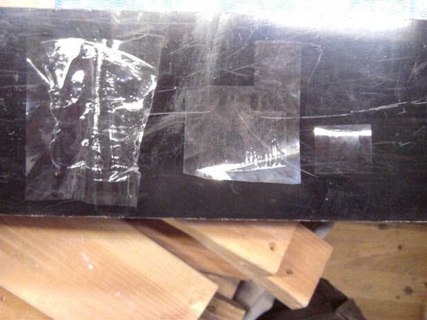

After doing this for about 5 minutes (aluminum plates should be too hot to touch), the assembly was removed from the vice. Don't have some aluminum plates and/or a vice? Unfortunately, you'll need to borrow one for this step. The results below show what happens if you don't happen to use a compression based technique:
Far left: No compression at all. Mylar shrinks and buckles a bunch from the applied heat. Middle: one aluminum plate on top...so minimal pressure. Most of the severe bubbles are gone, but you can still see a lot of bubbles that didn't get their way out of the film layer. Far right: beautiful bilayer that is essentially bubble free, and awaiting some catalyst sandwiching!
So, in short, good news everybody! Looks like the film creation for this sensor will work out well...now to build the sensing array and do all the math...more on that next post!
