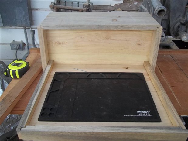

Here is a picture of all the pieces cut and roughed together (NOTE: The cut outs for the outlets and fume extractor are not yet made).
This is a rough cut, but the base will be ready to glue and clamp after some sanding.
The base is 14" X 16". I butt joined two 1X8's to make it. Of course, I surrounded the base with a lip because I am notorious for dropping small screws and hate crawling around the floor looking for them. The black pad is an ESD safe repair mat. I chose this mat because it is not only the right size, but it also has a temperature coefficient of 300C for hot air and can take a 230C direct hit. The built in trays should also help me save some headache caused by screws and such. However, this mat doesn't have a lug, so I will set it on top of a piece of grounded flashing to make sure it doesn't build up electrons. I will also put a piece of 12X12" tile under the mat to help diffuse heat.(You can find out more about this ESD mat here).
The first step for this project is making the base. This is what I did:
  1. Butt joined two 1X8" together with Gorilla Wood Glue.
  2. Cut the joined 1X8's square at 14"
  3. Ripped another scrap piece of 1X8 into 1.5" sticks.
  4. Cut the 1X8's to length for the front and the sides, allowing for the overhang.
  5. Made the dado cuts for the half lap joints.
  6. Dry fit the pieces together and made adjustments as necessary.
  7. Sanded the lapped out portions.
  8. Clamepd and glued.
Some notes:
  1. Make your cuts too long. It is easier to cut a blade's width more off. Most of us don't posses a board stretcher image.
  2. Use a C clamp to hold your sides when lapping out the bottom. Also, use another stick to move the wood slightly while cutting. Be careful so as not to lose fingers.
  3. Dry fit the pieces as you go. Cut too short or too long as the case may be. Then as you dry fit, shave off a little bit and dry fit it again. Repeat this until you have a good fit.
