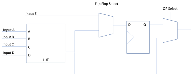

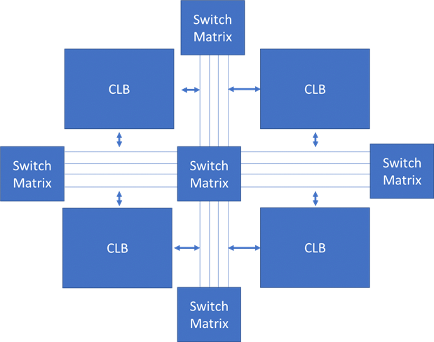

FPGAs on the other hand are not a class of processor; instead, they offer a range of logic resources such as Configurable Logic Cells, Block RAM,  DSP elements, etc. (Figure 3) As such, FPGAs are programmed using designs which configure and connect the logic resources to implement the desired algorithm.
FPGA performance is therefore measured by the clock frequency with which the design can achieve timing closure. In an FPGA-based algorithm implementation, each clock cycle could be performing mathematical operations. This frees the FPGA developer from the sequential world found by DSP developers and allows the implementation of signal processing pipelines and parallelisation dependent upon the resources of the device. Traditionally, FPGAs have been considered harder to program than DSPs due to the different architecture and the need to consider timing closure.
Figure 3: FPGA Architecture
Figure 4: Simplified CLB Architecture

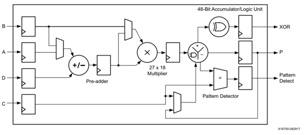

At the heart of many signal processing algorithms is the Multiply Accumulate operation, which is used when implementing Finite Impulse Response (FIR) Filters. The number of Multiply Accumulates which can be performed in a second is therefore often used as an indication of raw performance, and reported as MACS or Multiply Accumulation performed per Second on device data sheets.
Of course, DSPs are also capable of working with floating point numbers; as such the floating-point performance of a DSP is reported as Floating Points Operations per second or FLOPS.
When it comes to performance, FPGAs blow away DSP-related solutions. For example, a Xilinx Virtex XCVU27P contains 12,288 DSP elements. According to the Xilinx Virtex data sheet, each of these is capable of being clocked at 891 MHz Maximum, which gives a maximum MACS of 10,948 GMACs.
Figure 5: Xilinx Seven Series DSP Accumulator
By comparison, a DSP processor offers performance in the range of hundreds of GMACs (e.g., the 307 GMACs (TI 66AK2H14).
