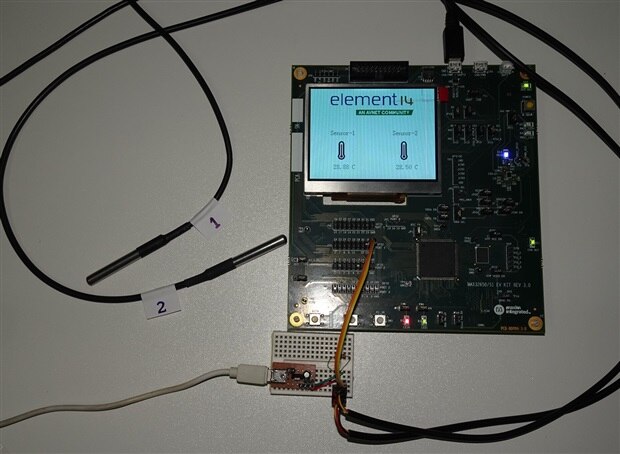

Details:
In this project two DS18B20 1-wire temperature sensors are used. Both these sensors are interfaced using the only 1-Wire master hardware interface of MAX32650 available at Port 1 Pin 31. The one wire master interface pin is also output pin for bit 1 of CLCD module red color. So in order to use this pin as 1-wire master we need to exclude this pin from CLCD module GPIO initialization. And one of the way of doing this is given in section below. In this project only basic features of DS18B20 sensor are used i.e reading the ROM codes and temperature values only.
Modifying the sensor configuration registers is not done in this project but anyone can do it easily by using the one wire SDK library. The difficult and lengthy part of code when working with 1-wire sensors/devices is searching and reading the ROM codes. And in MAX32650 has made programmer's life much easier by taking all these things to hardware side. And now we can do all these thing by just calling the SDK OWM_SearchROM function. All the code details along with display function is given in next section.

Sensor Initialization function can be used for multiple sensors (upto 1-wire bus max sensors limits) and number of sensors can be defined by TEMP_SENSORS macro at the beginning of the code. It will automatically search and read the ROM code of all the sensors using MAX32650 1-wire master interface.

After reading the ROM code of all the available sensors, we can read the temperature data of each sensor by using the ROM code of corresponding sensor.

Modify the following LCD GPIO pins in mxc_pins.c file as shown below: (mxc_pins.c is SDK file and in order to modify this file, first you need to uncheck the read only property of this file and also this modified code will be used by all the MAX32650 projects unless reverted back to original one)
/*    ORIGINAL CODE    */
//const gpio_cfg_t gpio_cfg_clcd_1 = { PORT_1, (PIN_3 | PIN_20 | PIN_23 | PIN_24 | PIN_25 | PIN_26 | PIN_27 | PIN_28 | PIN_29 | PIN_30 | PIN_31), GPIO_FUNC_ALT2, GPIO_PAD_NONE};
//const gpio_cfg_t gpio_cfg_clcd_2 = { PORT_2, (PIN_2 | PIN_3 | PIN_6 | PIN_13 | PIN_14 | PIN_15 | PIN_16 | PIN_17 | PIN_18), GPIO_FUNC_ALT2, GPIO_PAD_NONE};
/*    MODIFIED CODE    */
/*    remove the port2 pins that can cause hardfault as mentioned in MAX32650 ERRATA sheet    */
/*    remove the port1 pins that is only 1-wire master hardware interface pin    */
const gpio_cfg_t gpio_cfg_clcd_1 = { PORT_1, (PIN_3 | PIN_20 | PIN_23 | PIN_24 | PIN_25 | PIN_26 | PIN_27 | PIN_28 | PIN_29 | PIN_30), GPIO_FUNC_ALT2, GPIO_PAD_NONE};
const gpio_cfg_t gpio_cfg_clcd_2 = { PORT_2, (PIN_2 | PIN_3 | PIN_6 | PIN_13 | PIN_17 | PIN_18), GPIO_FUNC_ALT2, GPIO_PAD_NONE};

Demo:

    I have attached the project files along with .hex file.
    main.c contain DS18B20 related functions, basic GFX library for MAX-32650 EVKIT onboard LCD with modified display controller setting to obtain full resolution.
    For safety only hardfault handler function is also added and it will automatically reset the micro controller in case of any hardfault (I haven't experienced any hard-fault after modification of SDK files).
    frame.h contain fonts data, Element14 logo, Thermometer logo, Basic display color index in graphics palette and display color palette.
    Proper display function you need to modify the SDK files as shown above otherwise there is a possibility of hardfault.
