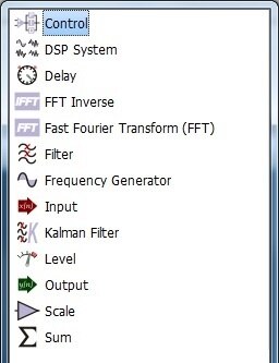

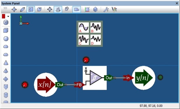

To create the program I added a DSP System component to the panel and then edited the components properties to create 2 buffers, one called feedback and the other called output. We do not need too much precision in this example so I have used 8-bit unsigned buffers.
Next I added a DSP input component and configured it's properties to point to the DSP System buffer manager and to pass it's data to the buffer named Feedback. I then added a DSP control component and assigned the feedback buffer to the feedback buffer property and the output buffer to the output property. To finish off the system I used a DSP Output component and again connected this to the output buffer. Finally I added two ADC components and an LED component to the panel, renamed them to FeedbackADC, SetpointADC and LED1 then positioned them near to their respective portions of the DSP chain.
Each DSP component has certain macros to allow the behind the scenes mathematics to be called. The maths functions know where to get the incoming values and where to store outgoing calculated values because of the property buffer assignments we did above. This makes the program nice and easy and is only really a case of calling a component macro for each DSP icon we have on the panel in the correct order to allow the DSP chain to run correctly. Each macro call comes in a Standard and Tick format. The standard macros will process the entire buffer a segment at a time whereas the tick macros will only process a single segment of the buffer.
For the DSP chain we have created we have to call the functions in this order.
SetpointADC :: GetByte
FeedbackADC :: GetByte
DSPInput1 :: AddAsByte
DSPControl1 :: Process
DSPOutput1 :: ReadAsByte

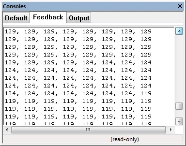

The console window creates a tab for each buffer on the DSP System, each line on the console shows the values inside each of the DSP buffers. If the buffer has 8 segments then there will be 8 values on each line representing the value in each segment. This is very useful for checking that the mathematics is doing what it is suppost to be doing before downloading the program to a microcontroller device.

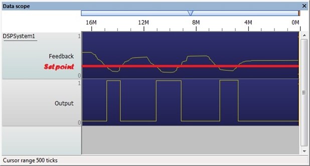

The scope window creates a DSP system group and adds each of the DSP buffers to the group as a trace allowing the data to be seen in a graphical format rather then a numeric format. Again this is useful for debugging and to ensure the system is going to be stable and respond correctly to the inputs provided. I have superimposed the set point value onto the trace to make it easier to see what is going on. By selecting the scope window and then scrolling down while hovering the mouse towards the right hand side of the scope window the scope will zoom out allowing you to see much more of the signal data over time.
