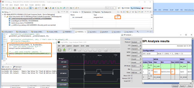

And the code kind of works. It executes without errors and I see the results on the logic analyzer.
Unfortunately* it doesn't work. The display doesn't react on the code. I was expecting to see a yellow square and a green line on the display, but it does nothing.
* That's OK. I have a sound starting point that allows me to get this working. And I have a working set-up too. I can always execute the test on an MSP430 LaunchPad here, and probe the traffic with the analyzer.

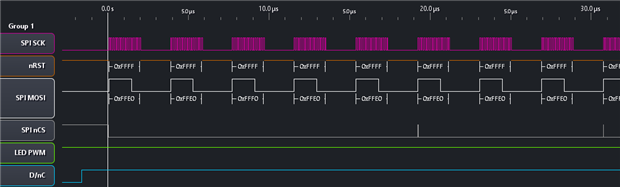

image Since I published this blog earlier then expected (I planned to save it as draft, but pressed the wrong button) I'll fork off the next section to part 4.
It 'll contain captures of SPI traffic going to the LCD. A trace here to prove that I have traffic image

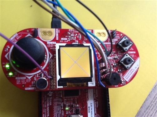

    Jan Cumps over 10 years ago

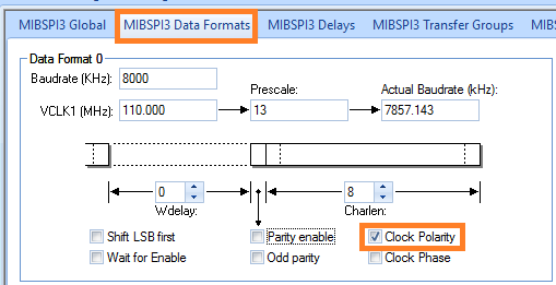

    I have it working. The issue was that I didn't correctly set up the SPI mode (mode0).
    I detected this when the call:
          _writeData88(0x0A, 0x14);
    showed a different value on my logic analyzer when I set the analyzer to mode0. It showed it correctly in other SPI modes.
    So I reconfigured my SPI peripheral (I had to invert the clock parity)
    Action Photo:
