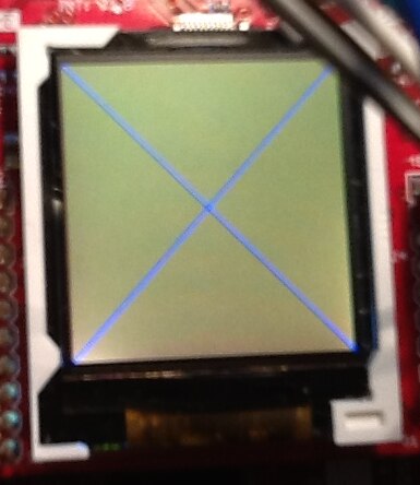

The screen image below is created with three lines of code.
    clear(orangeColour);
    line(0, screenSizeY()-1, screenSizeX()-1, 0, blueColour);
    line(0, 0, screenSizeX()-1, screenSizeY()-1, blueColour);
All good - and the LCD listens. My base line is set.
I have the Educational BoosterPack's display running on the Hercules LaunchPad.
