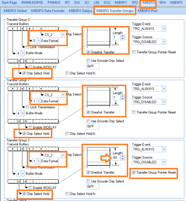

Configure the MIBSPI driver
Our display is connected to the pins of Hercules MIBSPI3. The display requires three additional pins to drive the backlight, a data/command selector and a reset line. These have been discussed and configured in blog 2 and 3.
That means that for SPI, we have to configure the clock, MOSI and CS (the display's chip select is connected to CS number2).
We don't need MISO, because the display never sends anything back to us.
First enable the MIBSPI3 driver. We use buffered SPI - we take advantage of that buffer mechanism when displaying bitmap images.
Then enable the Pin Multiplexing for the three SPI lines. This is additional to the PINMUX activities from post 2 and 3.
We're using 2 MIBSPI data formats. One to send 8-bit data. The other for 16-bit.
In the settings below, I've put the moderate line speed of 8000. I've had success with settings up to 30000.
Don't forget to set the clock polarity flag. That's the one that takes care that the data is set up as expected by the LCD (SPI Mode 0).
These two data formats are used in our transfer groups.The library uses three groups. One for 8-bit single shot, one for 16-bit single shot and the last one for a buffered stream of  64 16-bit values.
The two 16-bit groups use the same data format.
The last setting is to make our 3 SPI lines functional and make them outputs. As indicated before, we don't need MISO in our scenario.

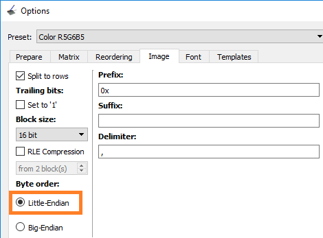

Bitmaps
I've prepared the bitmaps with LCD Image Converter. This utility creates C arrays from 24-bit bitmap files.
Make a 128*128 px image. Import it in de converter. Replicate these settings
The RM46 is a little-endian device.
Push preview, and copy the content of the popup window.
You can paste it over the HerculesMCUs[] array in the file bitmapdemo/16bitdemo.c.
The firmware will then show your image.
Have fun.
