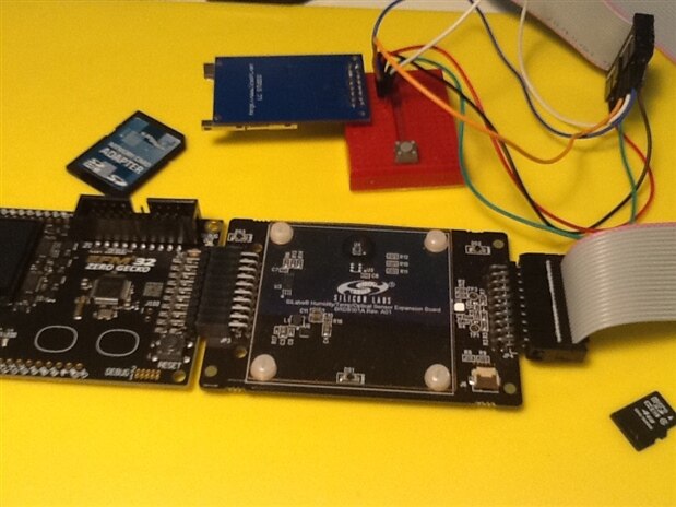

Inspired by the Zero Gecko Starter Kit roadtest review of  baldengineer , I'm going to try if I can get the weather station example log its data to an SD card.
The example shows its data to the lcd screen by default. I wonder if it's possible to log to a microSD in stead.
We already have the weather station up and running, and we have a working SD card example.
But there are roadblocks: baldengineer has made an attempt to do this, and he ran out of memory space.
I've made  some calculations based on the memory footprint of both examples,and they exceed the available resources significantly:

Update: working data logger + wiring diagram
You can follow the steps I took to get to a working example in the comments below.
The example I have attached here is functional, but not optimized for energy and sturdiness.
What should happen for energy optimization:
  1. The processor should go in low power mode in between measurements
  2. Complete power-off of the SD card when not writing
  3. Buffer measurements and write to SD card when buffer is full
What should happen for sturdiness and user experience:
  1. A mechanism to safely remove the SD card while not being written (maybe a button push when you want to remove the SD card, a led blinking slow when the card can be removed, and the led flashing fast when the buffer is reaching its limit while the SD card is out
  2. Management for file full
  3. timestamp
Size statistics with full debug configuration:
arm-none-eabi-size "STK3200_weatherstation_sd_logger.axf"
   text   data    bss    dec    hex filename
  32536    120   1384  34040   84f8 STK3200_weatherstation_sd_logger.axf
Size stats with release target and size optimization:
  16924    116   1380  18420   47f4 STK3200_weatherstation_sd_logger.axf
The wiring
The project is attached here. Good luck
STK3200_weatherstation_sd_logger.zip

    Wiring info:
    Jan Cumps over 11 years ago
    Success. I've attached the project to the original blog post.
    Here's the content of the log file after 8 samples:
