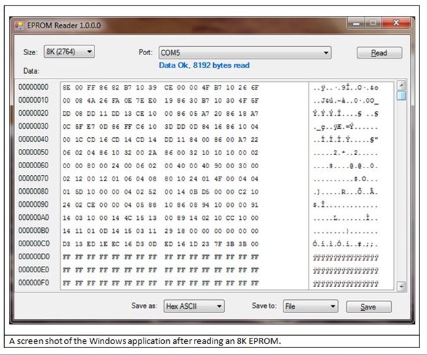

Next was the Windows software application. I decided to use C#. My first objective was to create an app that sent a command to the Arduino telling it how many bytes to send back. While I was waiting for the parts to come in I coded an Arduino sketch that listened on the serial port and sent back a certain number of bytes depending on the command received. My goal here was to have the serial communications working before I ventured to get data from the EPROM.
My efforts resulted in a Windows application that tested for the presence of the Arduino with the “Reader” software, and once found would allow the user to select a “size”. Once the size was selected the user would click a button and the Arduino would start sending the bytes. The app would then place the resulting bytes in a list. Since this app was a precursor to the EPROM reading app I made sure that the size was something small. The command supported were digits from 0 to 6 and an asterisk. Sending a ‘0’ would cause the Arduino to send back one byte. Each consecutive number up to 6 would have the Arduino doubling the number of bytes sent back. The asterisk was a “Hi Five” sign. The Arduino would respond to this command by sending back a plus sign. The Hi Five acknowledgement was to test the presence and responsiveness of the Arduino.
A video of my tech notes for this preliminary project can be found here:
Tech Notes: C# Serial Programming
www.youtube.com/watch?v=N6fsy7-qyqY
Once I had the serial communications working it was time to migrate this knowledge and apply it to the software for the EPROM Reader. I modified both the Arduino sketch and the C# application to adapt them to reading the EPROM instead of just sending a few bytes over.
The list in the Windows application was replaced by a nifty hex dump component whose appearance resembles that of the venerable MS-DOS Debug when the “dump” command is used. The Arduino sketch was updated to provide an address to the EPROM, read a byte from the EPROM, and handle its control signals.

I then changed my code so that the EPROM reader would read the full 8K bytes and retested and much to my surprise it did not work. The Arduino seemed to just hang after a certain number of bytes. I once again started to tweak both applications. I reverted to the initial 20 bytes and this worked fine. I wondered if the number of bytes read was a factor. I started to increase the number of bytes read until I reached 1,200. From there I increased it to 1,600 and there it failed. Why The Fail?
I then tested again using the serial monitor and this worked fine. I increased it to 8K and this also worked, albeit slowly. I needed to see if the Arduino sketch was sending back information so I added code to make the integrated LED blink every 100 milliseconds as the Arduino was sending bytes. This showed me that the Arduino was doing something. I tested again with the Windows application and again it failed.
I concluded that the problem had to be in the Windows application. It was there that I concentrated my efforts. I looked over the event driven code, but I did not find any obvious anomalies. This worked flawlessly if the number of bytes expected were less than 1,200. It is then that it occurred to me that both the Windows application and the Arduino sketch need to know how many bytes are going to be transferred. I looked at the code that initializes this in the serial class and found that I had old code left over from my initial serial communication tests. The Windows application was expecting less bytes than the Arduino was sending. My guess is that once the Windows application stopped receiving the Arduino would at some point not know what to do with the pending bytes.
The Windows application was always expecting a different number of bytes than were defined in the Arduino sketch. I fixed that discrepancy and retested. It worked! The EPROM reader was now functional. The only issue I had was that reading 8K took a while. I wanted the application to display some sort of progress indicator to let the user know that it was still working.
I added another event to the serial class that fired once for every 200 bytes received. In that event I updated a caption on the application’s screen to let the user know how many bytes had been received so far. This, along with the blinking LED on the Arduino was enough to let me know that something was still going on, albeit slow.
