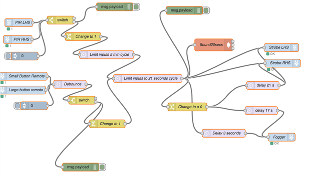

I also simplified the NodeRED flow by taking out most of the delays and loops.

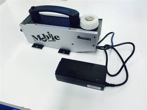

The amount of smoke produced by the hand held 12V fog machine I had used was great for indoors ...
but outside it got blown away too quickly. My next step was to adapt one of the larger mains powered fog machines used by the Park. These have to be permanently powered and the smoke output is controlled with a switch, so I could not power them through the relays. The hand held one was almost instantaneous - power on and smoke comes out.

I therefore changed the pins for some of the inputs and outputs.
I also had to de-bounce the remote control - when triggered it sent two messages. I put a "limit messages" node in to fix this.
The whole system is now ready for the Park to install at their next event - Chinese New Year.
