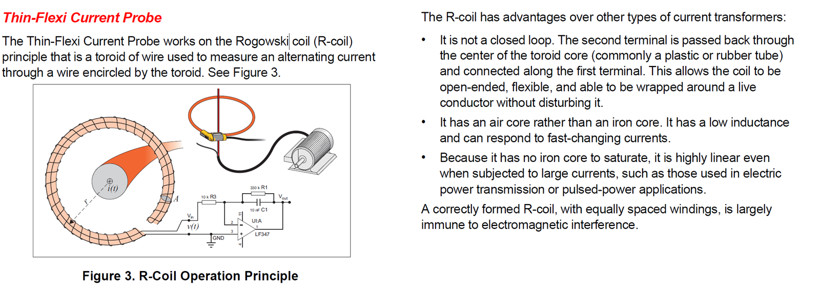

The instrument comes with Rogowski based current probe and voltage probe with giant crocodile clamp. Rogowski coil probe has some benefits as listed in diagram below.

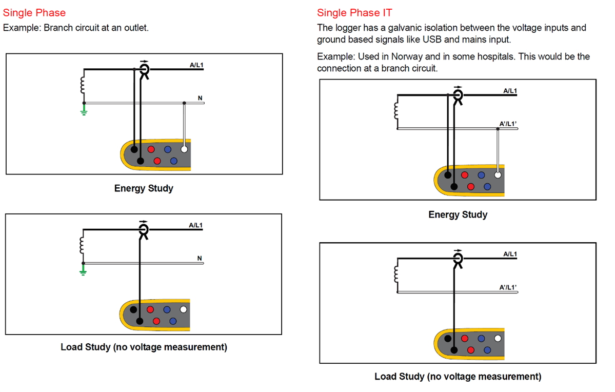

i am at a location that only has single phase power outlet, so i create a mock up induction motor with exposed life cable, so i can do a quick load monitoring as well as energy monitoring. the former only need to measure current while the latter need both current and voltage. The configuration editor in 1732 provide a graphic diagram showing user how to do the connection.
my super simple single phase induction motor setup for measurement with Fluke 1732.
and figure below shows the configuration diagram that the instrument will show (although this i grab from user manual)

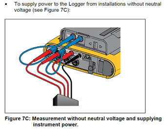

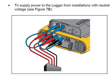

image i like its capability to be powered from the power lines that you are actually measuring at. this can be see from its supplementary manual
