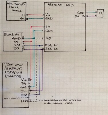

I liked this idea. Chris called it formalized synesthesia; this twisting of how we look at a problem gives us a different way to think about it. I didn’t realize before we spoke to Dr. Fishwick that I’d been working on a model of sorts. I have a project over at Hackaday called North Star.
Some people find inertial sensors confusing. They work like magic, measuring unseen forces. Of course, accelerometers measure accelerations. I dare you to tell someone that and not have one of you feel like an idiot. The eye-glazing should be well on its way by the time you get to magnetometers and how they measure magnetic force.
I wanted a gadget that I could use to explain the differences between accelerometers, gyroscopes (angular rate sensors), and magnetometers. I hooked these up to an Arduino, a smart LED, and a button.
In accelerometer mode, the system shows 1G of X acceleration as red light, Y as green, Z as blue. Mostly it shows how the largest component of acceleration is gravity. Sure, when I move or vibrate the device, it changes a little. But accelerometers mostly measure gravity. And taps (tapping the device emits a spark of mostly white light, taps are neat).
In gyro mode (button presses move between modes), the LED is off when the system is motionless. Gyros are boring unless they are moving. Rolling or turning the device shows the same colors (XYZ -> RGB) with the intensity proportional to speed.  Gyros are great for measuring change.
In magnetometer mode, the light is white if you are pointed north, green if east, red for west and off for south. It lights your way north (hence the project name: North Star). In most systems, magnetometers are used to orient the device to the real world.

The North Star project uses:
  • - An IMU similar to the the ST Evaluation MKI124V1 with L3D20 (gyro), LSM303DLHC (accelerometer and magnetometer).
  • - An Ardunio UNO
  • - An I2C controlled LED
