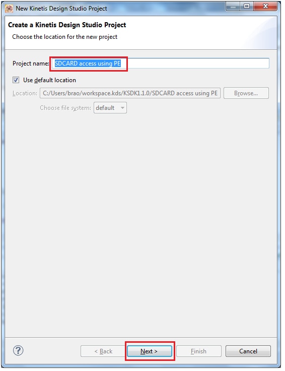

I have created a project by name “SDCARD access using PE”

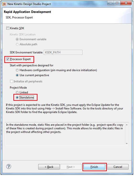

Make the selection of processor expert in standalone as shown below:
Click finish.

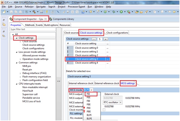

Now click on Processor component
And make the clock configuration as shown below:
Next change the clock configuration-3 as shown below

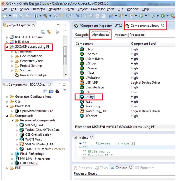

Now we will proceed further by adding our components:
Select component library and select FAT_FileSystem

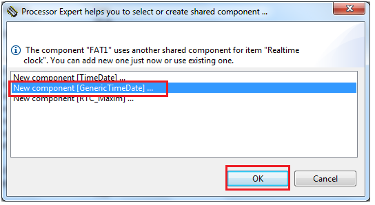

It will ask for you to add the shared components as shown,
Next select “Real time clock” as shown

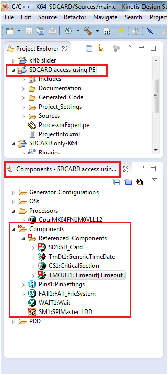

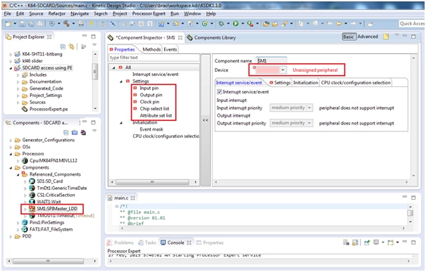

Now it will create corresponding components in our components window
Now you can see the different shared components created for FAT_FileSystem
We need to make the corresponding settings for these components as you can see a red cross on it which indicates it has error in settings.

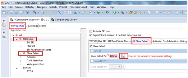

We will go for SD_Card settings
By clicking on slave select pin it prompts for LDDSS where you need to assign hardware pin PTE-4 as shown:

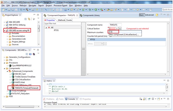

Next coming to TimeOut component, click on it.
Now coming to next component, i.e SPI Master

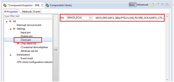

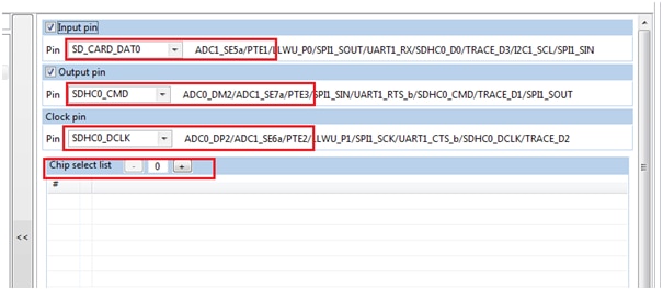

SD-card is connected through SPI interface so we need to assign the spi block and its corresponding pins for it.
Here the K64 board is connected to SD card slot via SPI-1
Select the input pin connect to PTE-1 as shown
Next output pin connect to PTE-3 as shown
Next clock pin connect to PTE-2
And there is no chip select used hence make it zero by clicking on “-“ button
Now the SPI interface looks as below:

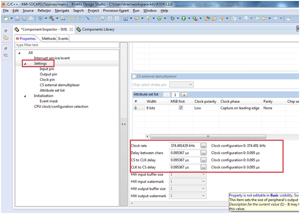

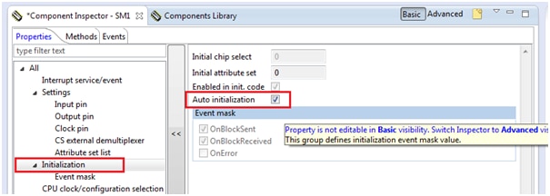

And make the auto initialization radio button to on by clicking the check box.
Now need to select the clock rate speed required for SPI interface.
Make the settings as show below:
Now we need to add the component ‘Utility’ this is required for commonly used utility methods, especially safe string copy/concatenation routines.

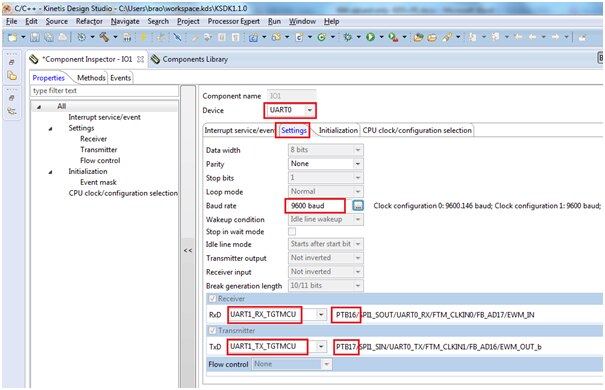

Next select UART0 window from pin configuration main menu as shown below:
As UART0’s RX is connected to PTB16 and UART’s TX is connected to PTB17.
This UART port pins are required for console terminal output.
Next click on ConsoleIO_Serial_LDD button as shown below:
We have configured UART0 as shown below:

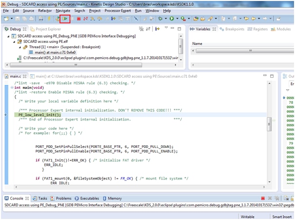

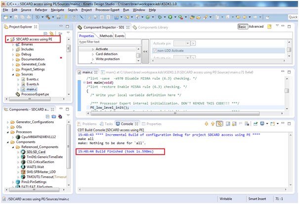

Now it’s time to build the project, click on the hammer button as shown
You can see the build is finished successfully with no errors

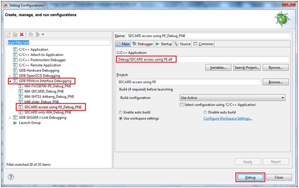

Now it is ready to debug/execute
Click on Debug configuration as shown below:

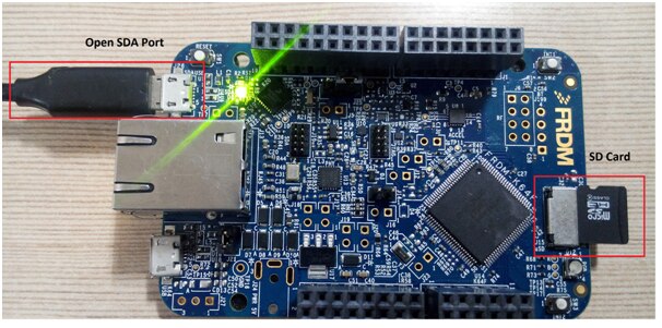

Now connect the K64 board to OPEN SDA port to your computer through USB cable, Then click on Debug button. And insert a SD-Card in the slot as shown below

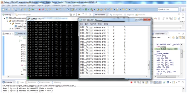

You can see below Debug window screen
Make sure you have open the corresponding hyperterminal window from your ‘Computer Management’ Device manager window:
In my case it is connected to COM23 port
Now click on green ‘Resume’ button

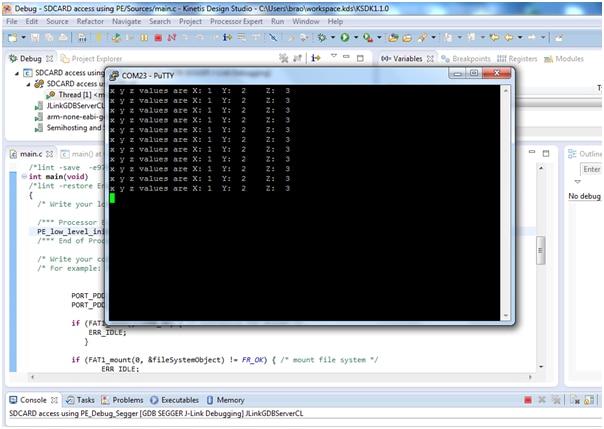

Open COM23 port from any of the hyper terminal application (putty in my case)
The output seen in the terminal is as shown below:
The output seen in the sd-card
Remove the sdcard from K64 and access it through card reader and explore the contents, it will show the new file created  “TEST_K64.TXT” as shown below:
The content of this file is as shown below:
