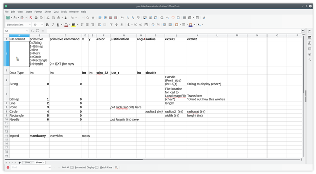

Here is the file format for the parameter file I am going to write on my desktop, copy to the SD card, and read from the NerO to display primitives on the CleO:
This should be a good test of the CleO’s file capabilities. In the introduction section on CleOstuff.com it says “The file system supports up to 8 simultaneous file operations.” So I am looking forward to see how it performs this task. The API is so clean I have designed my desktop app to write the code for primitives also. I will use this for my baseline for file I/O benchmarking.image
