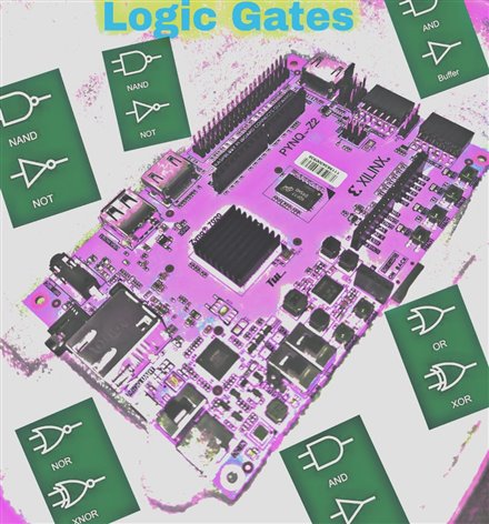

Hello World!
In this Blog, I would like to share my experience on PYNQ-Z2: Embedded Vision Workshop (Zero to Hero) Series with Adam Taylor!
Getting Started | Getting Up and Running  | Unlocking Your Inner PYNQ Hero  | Project14 | PYNQ Workshop image
and my getting started experience with the PYNQ-Z2 board.
PYNQ is an amazing framework and is an opensource project by Xilinx.
Reach PYNQ website at PYNQ - Python productivity for Zynq - Home
Now, coming to the core we'll see how we to create basic logic gates by using Python utility i.e, Jupyter Notebook.
Firstly, login to the Jupyter Notebook from your browser. You may have to assign static IP when connected your board to the computer directly via Ethernet cable. Else, the first boot must run hassle-free if your board is plugged to the router/switch directly(preferred).
Simulating Gates:
Logic gates are basic building blocks of digital electronics. Wonderful things happen when hundreds and thousands of them come together in an array. Time being, we'll see how it all starts.
