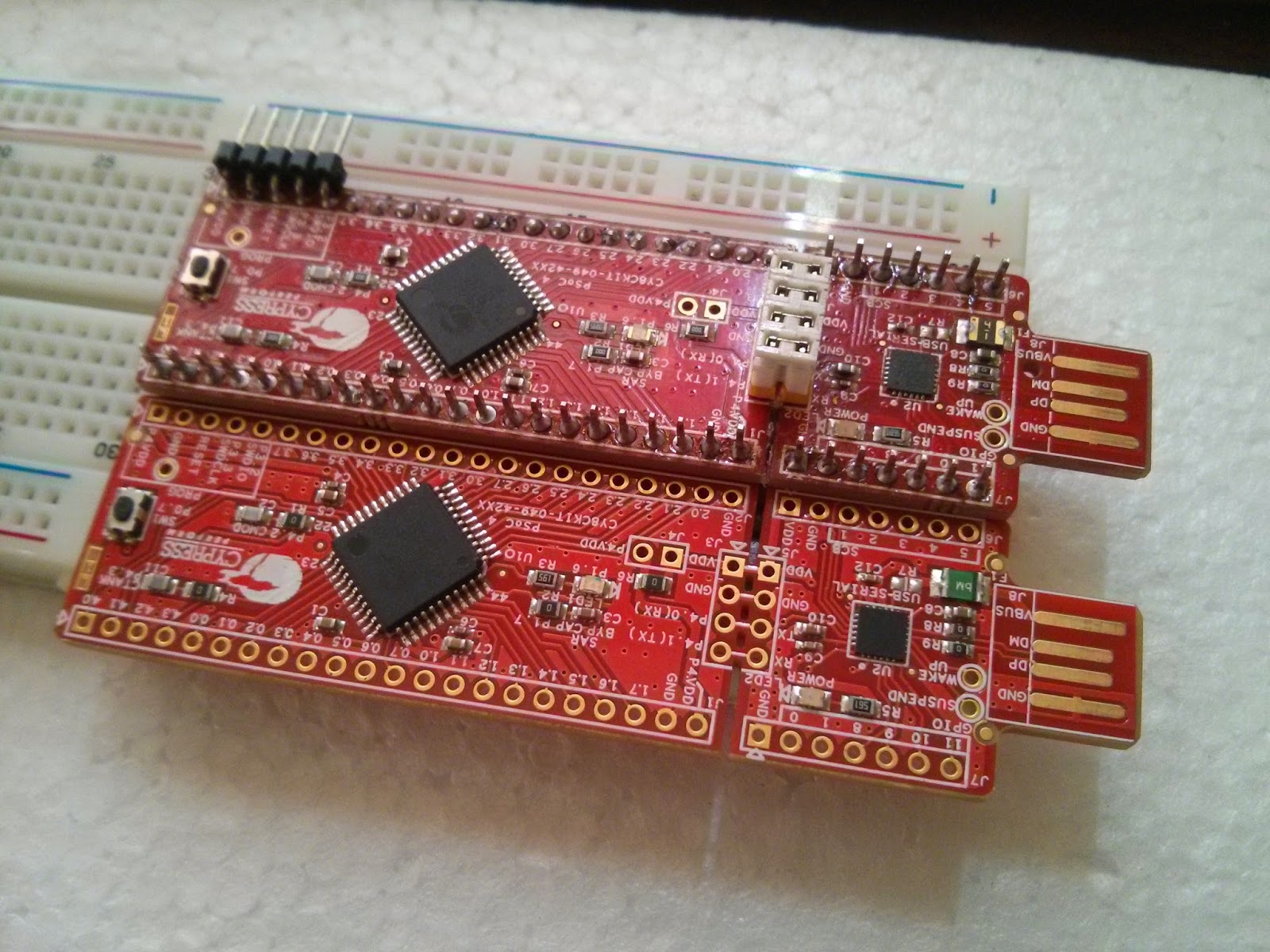

The 4$ Dev Kit is based on Cypress CY8C4245AXI SoC, and have a User LED, Current Measurement header, Boot/User Switch, ~40 GPIO's, A usb to UART/I2C/SPI convertor with GPIO's all in a breadboard friendly Format.[Refer image above].

2.1. Preparing the Board
For preparing the board you need couple of things,
1. Soldering Station
2. Flux and Soldering Lead
3. Long/ Short berg strip's 0.1" spacing (Standard headers)  22pins(2 nos.), 17pins(2 nos.), 7pins(4 nos.), 2pins(2nos.)
4. 90 Dig angled berg strip 0.1" spacing (Standard angled headers) 5pins(2nos.)
5. the Boards obviously image (2nos.)
STEP 1 : If you have a long berg strip, you have to break them into the above mentioned configuration (22pins, 17pins, 7pins, 5pins(angled) )
STEP 2 : If you have standard Headers solder them as shown in the picture below:

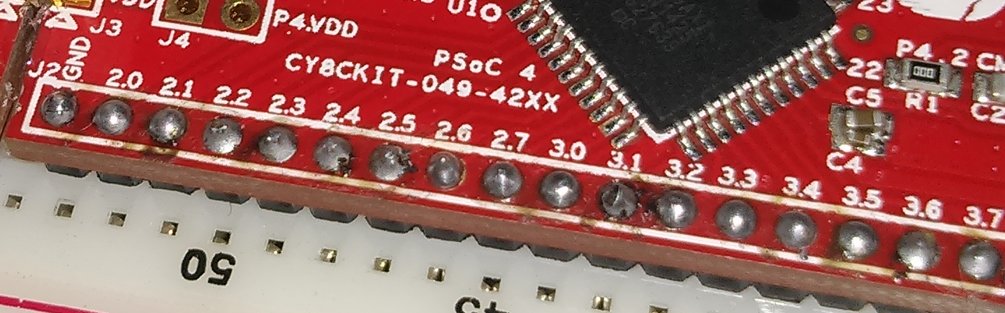

I usually like to plug the board on to bread board and try to use both the Breadboard as well as the Pins for connecting me External components. So, If I want a pullup resistor, I use the breadboard but for an external module interface I try and use the pins directly image image
So, To do that Follow the Steps Below image
STEP 2.1 : Insert the berg connectors opposite ways into the board as shown in the pic below.
STEP 2.2 : Solder the Berg Connectors on the board and, Remove the separator from the berg connectors as in the pic below.
STEP 2.3 : Insert the separator towards the Bottom of the PCB, with the notch towards the PCB. (As shown in the Pic above - the black part).

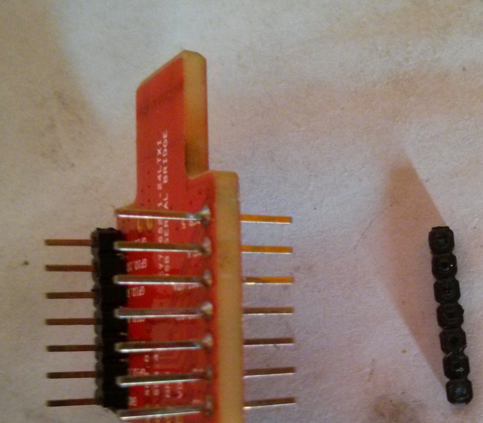

STEP 3 : If you want to use the USB to UART separately, then break the USB to UART section of the board from the body and solder 4pin berg connector 0.1" (standard/angled headers) on ether sides of the boards and you are done. Reference Images below,

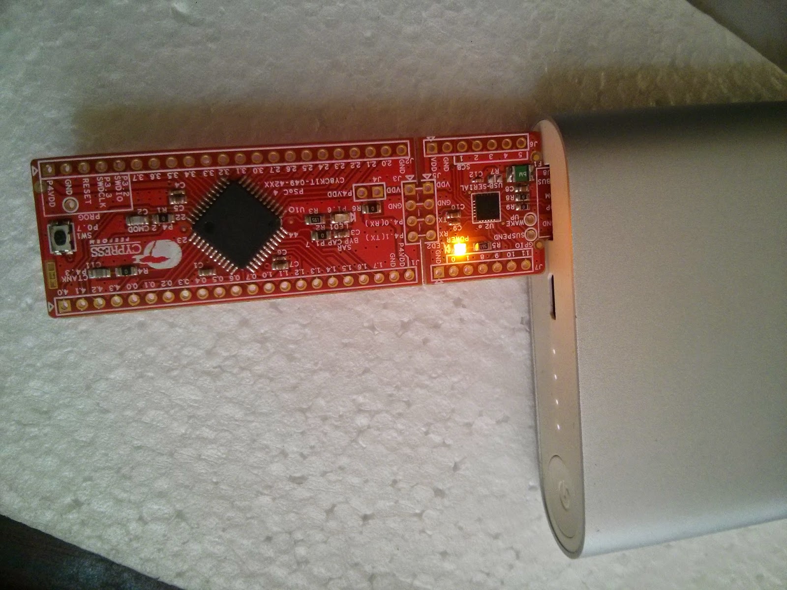

Step 4 : Testing that everything Works image
The most easy step image Connect the board to a computer's USB port/ Power bank and check the LED's Going off.
