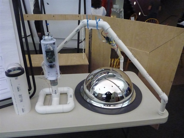

Camera #1 is the one that has the Gertduino mounted front-and-center. I do not yet have the Gertduino doing productive work within the camera housing (such as coordinating sensor readings) - that will come along over the next week or so - but I explained its key role in the camera design as I described the purpose and goals of the all-sky camera to visitors who stopped by to chat.
The concept behind Camera #1 is to take photos of the full sky by mounting a super-wide-angle fisheye lens adapter in front of an upward-pointing Raspberry Pi camera module's lens. You can see Camera #1 propped up on its custom PVC tubing stand at the left of the photo below - the Gertduino is clearly visible:
Camera #2 is visible at the right of the photo. Its design relies on an upward-pointing hemispherical mirror reflecting the sky for a downward-pointing Raspberry Pi camera module to capture. I haven't taken any photos with Camera #1 yet, but here's a sample photo from Camera #2:

    Yea, fisheye lenses are very tough to get with no distortion.
    I have heard that aspheric lenses are better, but I have not tried any of them.
    I suspect that you can get by with just 160 degree field of view, given the normal ground clutter.  It would also give you a better f-number ratio.
    It looks like Camera 2 would reduce blockage if you went to thinner metal rods instead of the PVC, but you might run into wind vibration issues.
    I look forward to seeing your cameras in action.

    Yes, Camera #1 should give an obstruction-free view, but the low-cost fisheye adapter lens suffers from focus problems and optical aberrations. So Camera #2 may turn out to have the upper hand as far as image quality is concerned.
    I have seen articles suggesting that a parabolic mirror may be better adapted to the sky photography application than a hemispherical mirror, but parabolic mirrors do not appear to be available off-the-shelf (at least, not at as low a price as the hemisphere). My goal for these camera designs is for them to be easily replicable with common materials, and so a custom parabolic mirror is pretty much out of the question (I have looked into possibly machining a mirror out of aluminum, or using vapor deposition of aluminum onto a plastic base, but both would be cost-prohibitive).
    I'd love to take some lightning photos, although the combination of tall trees in my yard and years of experience indicating that thunderstorms seem to mostly miss my neighborhood (due, I suspect, to local topography) may make it difficult to get a really satisfactory photo or video. The Pi camera module has some delay (that I have not found out how to eliminate) when taking still photos, but the latest firmware update to the camera appears to have added some interesting high-definition video modes which may turn out to be suitable for grabbing lightning videos. I have seen some great lightning photos taken with Canon point-and-shoot cameras using the CHDK firmware with automatically-triggered exposures, and would like to be able to do the same with the Pi, but it's not yet clear to me that it can be accomplished. I need to do a lot more work than I have done so far with the Pi's camera capture software, but I have some additional work to do on the electronics, network support, and camera user interface software before I get to do that.
    As for Camera #2, I hope to refine the camera support so that only a single arm is required, rather than a tripod. Camera #2 has always been intended as a proof-of-concept rig, rather than a weather-hardened camera, but the goal for Camera #1 is for it to be able to sit out in the weather 24/7/365.

    I like your approach.  Camera one gives you less obstructions and might end up being more sensitive to light.
    I have seen a lot of designs like camera two and they are very good, but you have to work out the spherical distortion to do a lot of good measurement of location of objects.
    I look forward to seeing your cameras in action.  Are you thinking of using the rig for lightning photographs?
