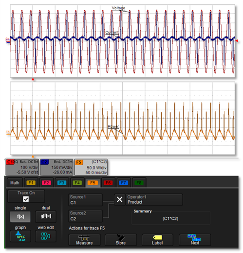

Parameter math functions are an important part of an oscilloscope's analysis capabilities. Using parameter math, you can create custom parameters based on simple arithmetic relationships between existing parameters. It allows you to add, subtract, multiply, divide, or rescale parameters (Figure 1).
Figure 1: Parameter math functions provide a way to create custom parameters
You can do things like inverting waveforms, multiply voltage and current to find power, or integrate a waveform to find energy and Joules. You can cascade measurements, or combine functions in a Math channel. Teledyne LeCroy's four-channel oscilloscopes provide eight Math channels; eight-channel instruments provide 12 Math channels.
With parameter math, you can combine parameters to calculate other parameters that Teledyne LeCroy oscilloscopes do not list in the parameter measurement listing, such as the crest factor of a waveform, or measuring the modulation index of an FM signal.

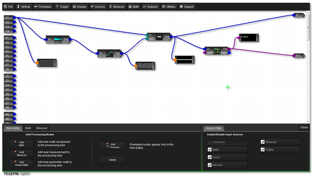

If you need even more complex custom math functions, there's always the
Processing Web Editor (or WebEdit for short). Let's face it: Waveform analysis is a complex affair in which you might need to link together a whole chain of math functions, parameters, and parameter math. WebEdit gives you a means of graphically constructing and modeling such math and measurement processing chains.
With WebEdit, you can cascade functions, or include things like Matlab scripts. There's almost no end to the possible combinations you can concoct with WebEdit. A preview function allows you to add little windows that will show you the output at the output of any operation, so you can check to see if what you're putting together is giving you what you expect it to, and this is independent of the oscilloscope application itself.
Figure 2: WebEdit lets you create a graphical processing flow by dropping in math, measure, and parameter math operations and connecting them together as necessary

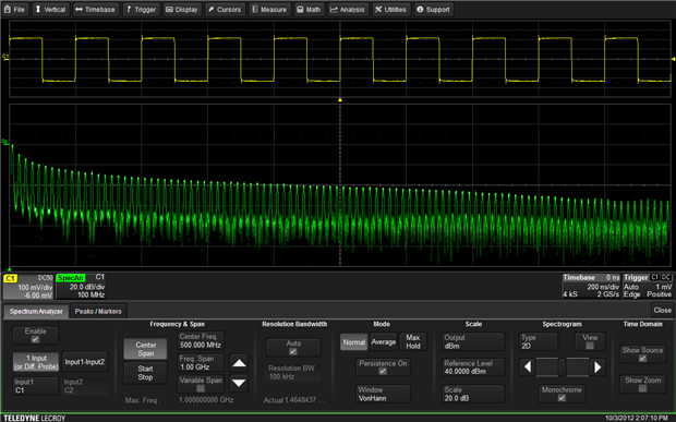

The ability to convert a time-domain waveform acquisition to the frequency domain is an important tool for oscilloscope users. Fast Fourier transforms (FFTs) are not new to oscilloscopes, and Teledyne LeCroy offers FFT as a standard math operation on most of its oscilloscopes. But that capability goes a step further with its Spectrum Analysis option. The Spectrum Analysis software greatly simplifies the process of setting up an FFT by providing a user interface that is familiar to anyone who's spent time with traditional spectrum analyzers (Figure 3).
Setup of an FFT is pretty simple: Select a center frequency, span, and resolution bandwidth, and the software will set the proper sampling rate and time-domain acquisition length. An automatic peak-detect function identifies all frequency peaks, labels them on the display, and creates an interactive table of the peaks. You can also see the FFT as a spectrogram that shows how the spectra change over time.
Figure 3: Spectrum analysis software provides a user interface familiar to users of traditional spectrum analyzers
