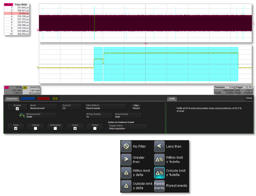

In earlier posts about how to maximize your oscilloscope's utility, we've discussed how to properly capture a waveform, making measurements, and extracting more meaningful information from those measurements that might be readily apparent. Now we'll look at how to correlate anomalous behavior from a waveform with other waveforms we may have captured. In many Teledyne LeCroy oscilloscopes, a front-panel push button brings up the WaveScan advanced search and analysis tool, which provides the ability to locate unusual events in a single waveform capture. It also "scans" for an event in many acquisitions over long periods of time. You can select from more than 20 search modes involving parameters such as frequency, rise time, runts, non-monotonic edges, duty cycle, serial- or parallel-data patterns, and so on. After applying a search condition, the tool begins scanning the waveform for events that meet the condition. Filter functions include rarest events, min/max parameter occurrences, within or outside limits, and Δ%.
Figure 1: Using WaveScan to search for rare glitch events
The example depicted in Figure 1 shows a scan for a glitch. After setting the conditions you're looking for, WaveScan reports its results in a table that is interactively linked to the zoom trace. In this case, we've captured a lot of data: 1 s worth spread over 10M data points. We set WaveScan to find the 10 rarest events with respect to pulse width.
In addition to setting up WaveScan to search on a specified condition, you also have options with respect to what happens when it finds that condition in the waveform. These include stopping the scan (in effect, a software trigger), saving the data in a LabNotebook, or saving a screen capture.
