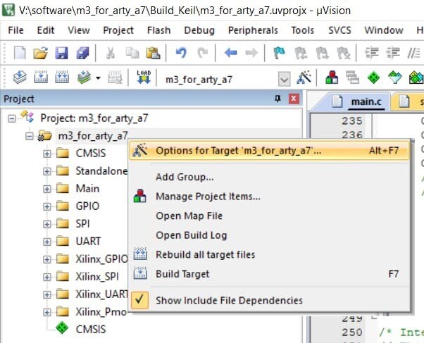

To use the J-Link within the Arm Keil environment we need to configure the target options, we can do this by right clicking on the top level of the project and selecting options for Target 'm3_for_arty_a7'
This will open a dialog box, we can select the JLink and configure the debugger as shown below
If we need to, we can further customize the J-Link set up, this enables us to change JTAG frequency and select if we desire to download the application to flash or not. In this case we do not want to download to the application to flash.
