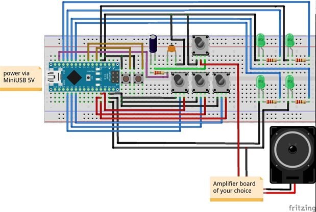

I used a breadboard. There were no Fritzing shematics so I made my own. The original design uses a female jack for output and you connect Glitch Storm to an amplifier. My schematic uses an 8Ω speaker as output and a small 2x50W PCB amplifier in between the build and the speaker.

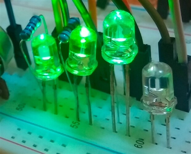

  • LEDs (4 of them) - I used green ones

The minus leg of the LEDs goes to Ground and the plus (the longer leg) of the LEDs are connected to a 1k resistor that then is connected to D7, D8, D9, respectively D10 pins of the Arduino Nano. The middle leg of three of the pots (used to modulate the sounds) go to the A0, A1, respectively A2 pins of the Nano board. Left leg goes to a Ground pin, the one on the right needs to be connected to the 5V pin of the Nano. One side of the two momentary push buttons goes to ground and the other to D2 and D4 respectively. Connect D11/MOSI on the Arduino to one leg of the ceramic capacitor and the other leg connect it to a Ground pin. Connect the fifth resitor to the same D11/MOSI pin and the other leg of the resistor connect it to the "+" (longer) leg of the electrolitic capacitor. The short leg of the electrolitic capacitor goes to the right pin of the last potentiometer, the left leg of the potentiometer goes to Ground and the middle one will be connected to the plus hole of the amplifier (while the minus part is connected to one of the Ground pins of the Arduino Nano).

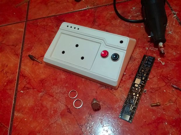

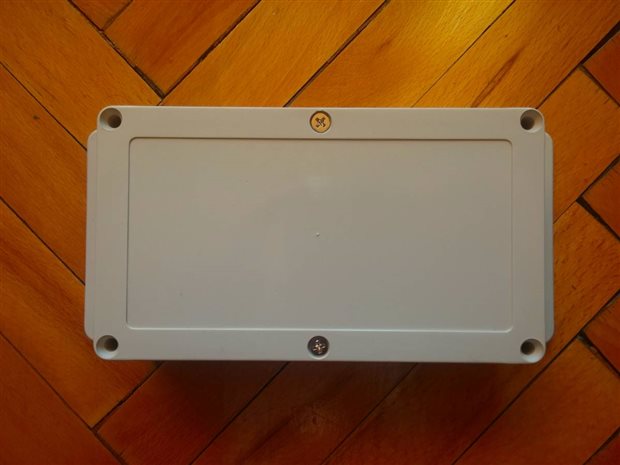

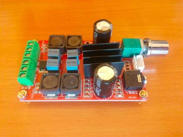

I bought a better amplifier board, some smaller speakers and a project box for the synth.
Here it is with the 50W amp board:

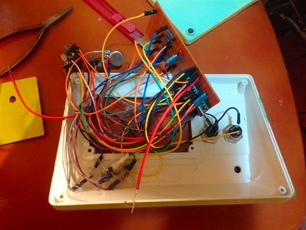

/January 7th update: decided to go with another box and started working on the prototyping board. Horrendous soldering skills but it works.

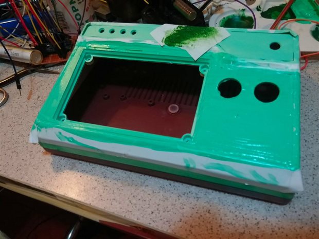

Started painting the box in more cheerful colors.
/January the 8th update:
The paint on the box is almost dry. Still needs a few corrections here and there but tomorrow I will apply a thin protective layer of epoxy resin on the box and let that dry too. It will make it glossy and it will brighten the colors.

/January the 9th edit: Almost done. Soldered everything and fitting it into the case on which I applied a thin layer of protective epoxy resin.
...aaaaaaaand Done!

    The schematic is wrong on the audio output. C1 should be the other side of the resistor R1. As it is the capacitor is directly across the output pin. Not only will this cause the Arduino to exceed the…

    That's the admplifier's own audio volume.

    What is that extra knob on the side in the latest video?

    Thanks for pointing out the errors in the schematic. I made it in a hurry and didn't notice them. Will fix them in Fritzing and will reupload the image.

    The schematic is wrong on the audio output. C1 should be the other side of the resistor R1. As it is the capacitor is directly across the output pin. Not only will this cause the Arduino to exceed the maximum pin current on peaks, but it also increases the cut off frequency as the output pin has an impedance of about 35R. So the filter is not cutting out the high frequencies like it should.
    However, great project, thanks for bring it to our attention here. I think the erroneous reference to MIDI came about from the original commercial project. No MIDI here. If you want to explore the opportunists of control by MIDI you would be better off using an Arduino Leonardo or Arduino Micro as these can present themselves as a USB HID MIDI output. Although I suspect that the time taken for the MIDI input will cause additional glitches in the audio output.
